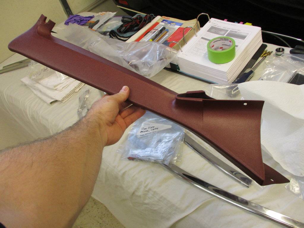

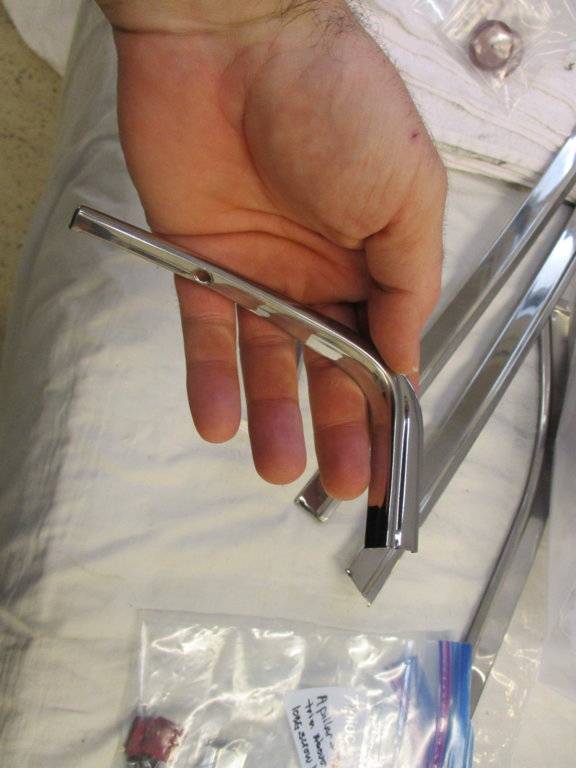

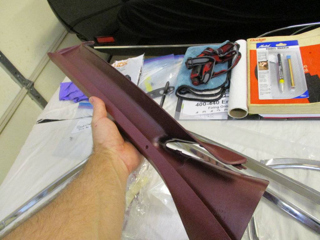

A pillars were restored by Instrument Specialties...
The stainless dash trim pieces were polished

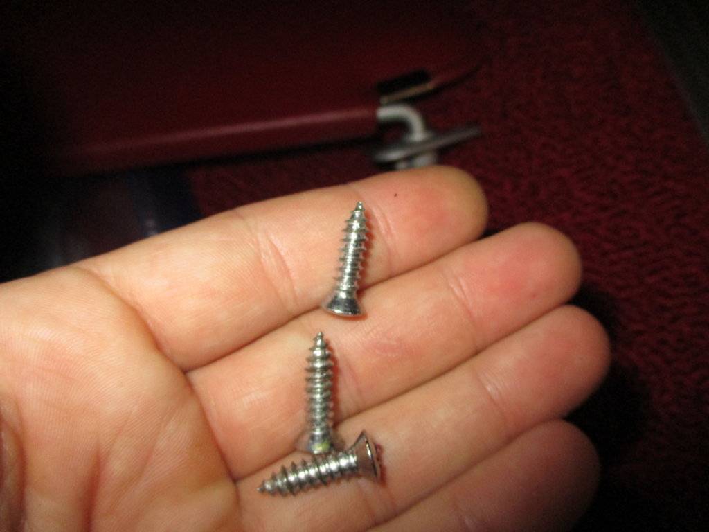

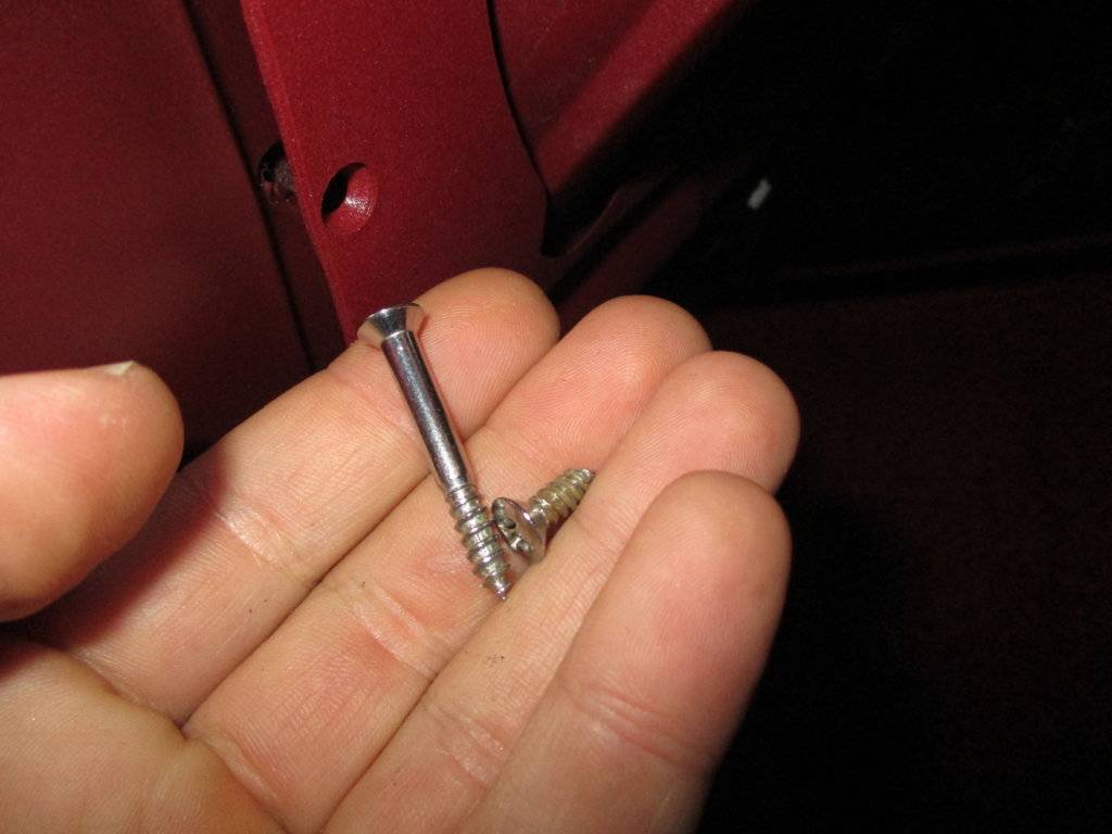

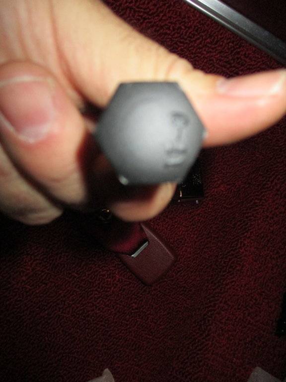

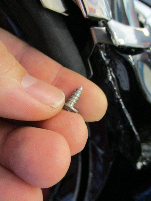

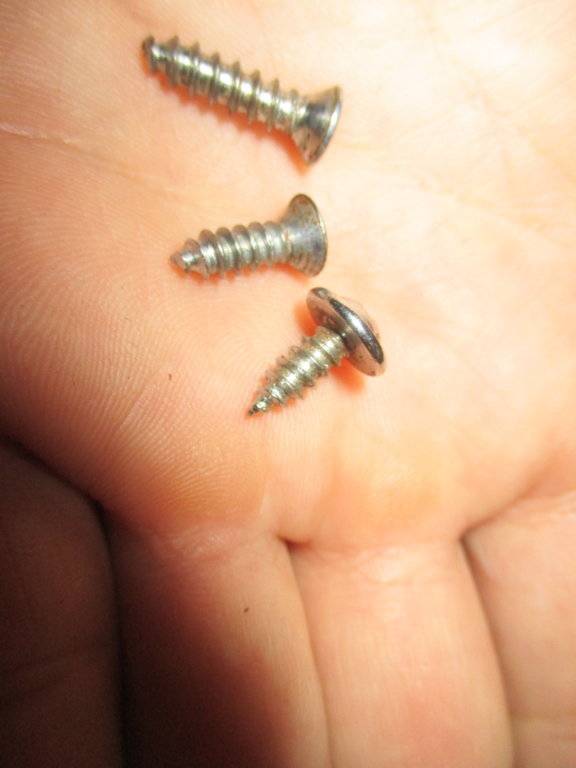

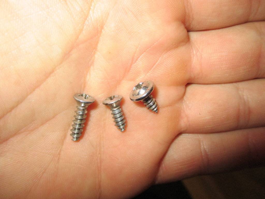

These are the 3 A pillar screws....
Short one goes on the underside of the dash. Longer one goes by the roof rail weatherstrip and the hard to find flat head goes on the dash in the door area..

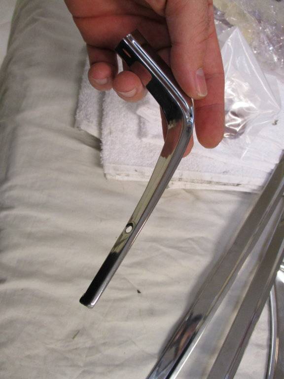

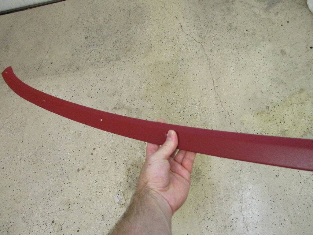

Upper windshield trim piece was restored by Instrument Specialties.
Original hardware as shown....Make sure to fit each end properly in the A pillar trim.....

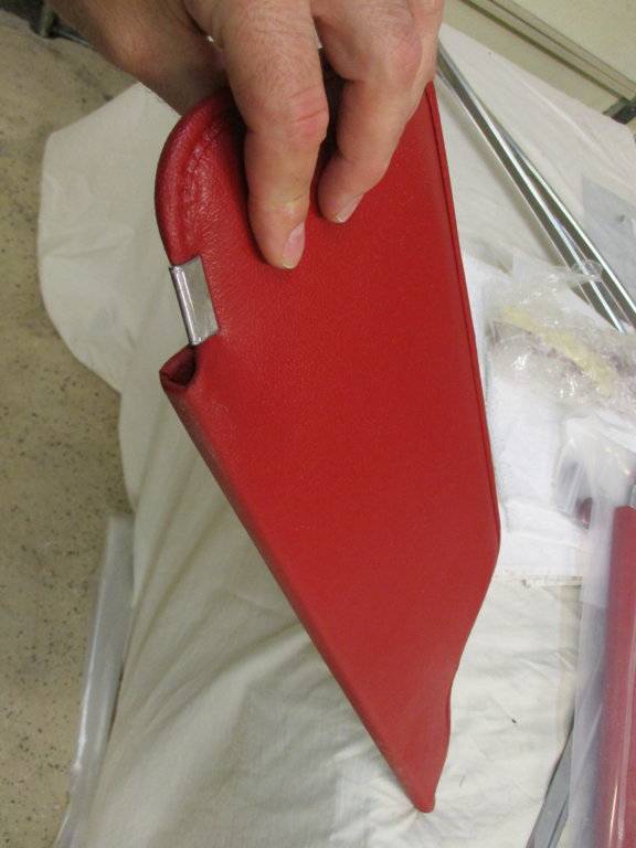

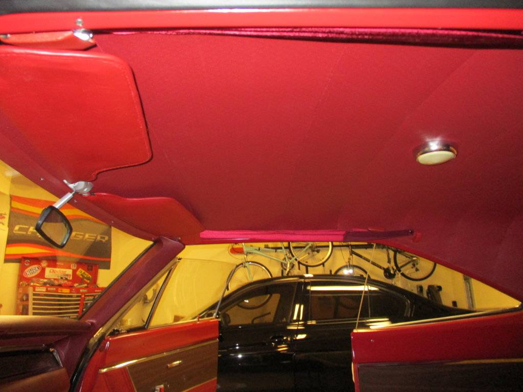

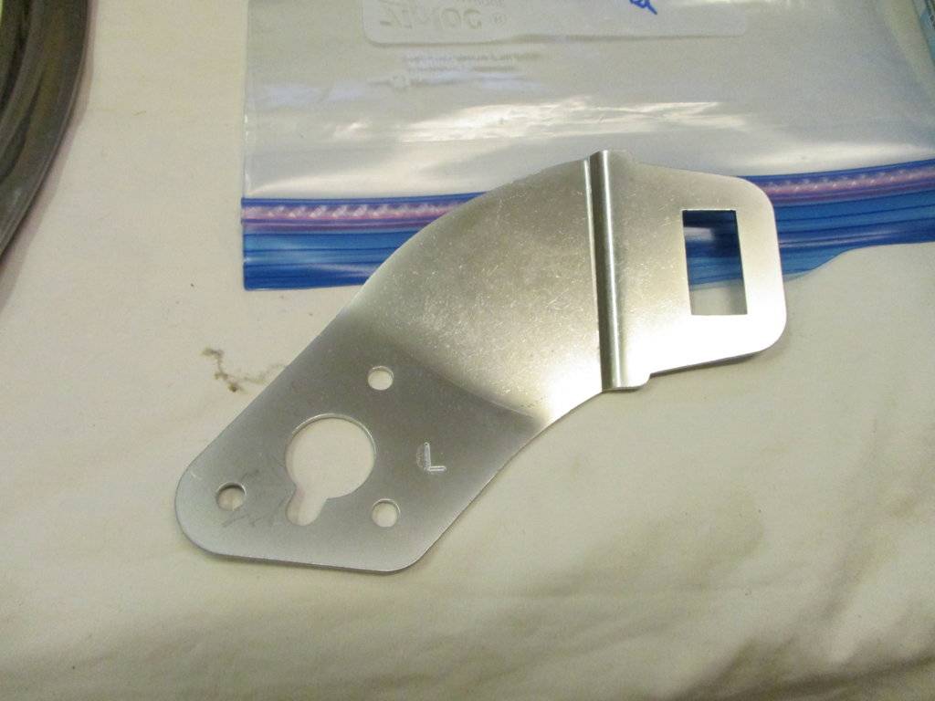

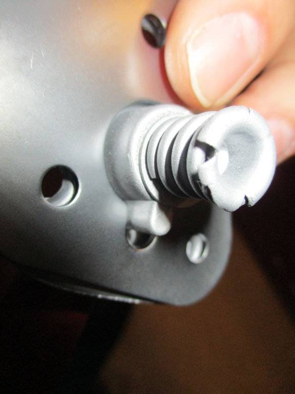

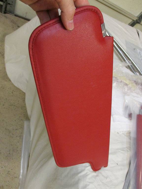

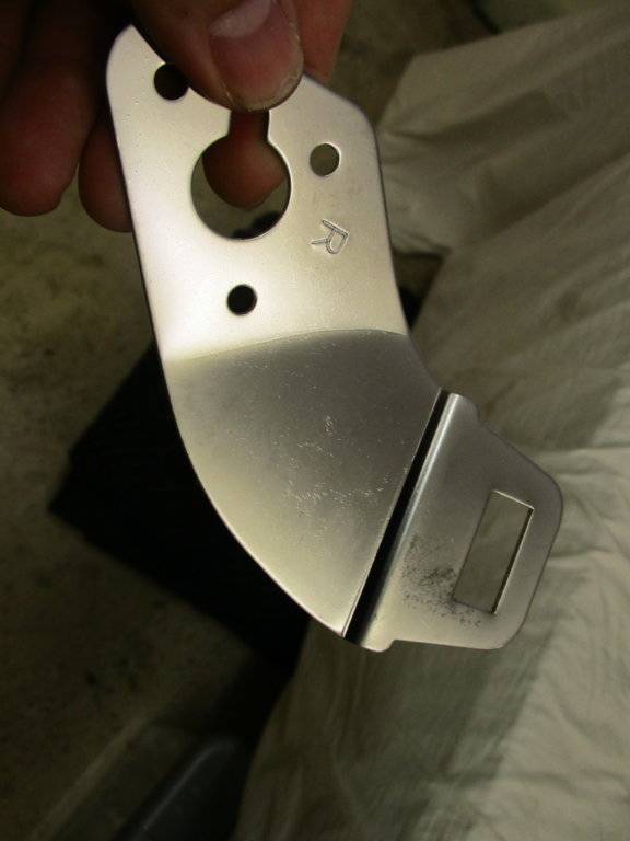

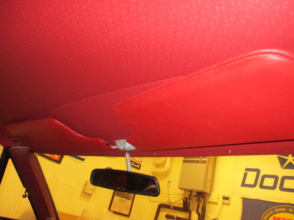

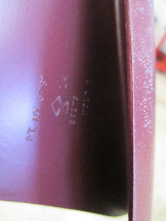

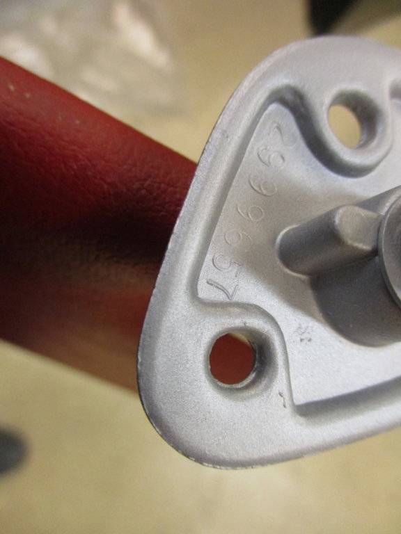

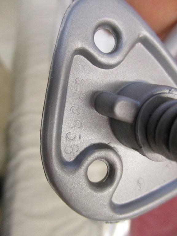

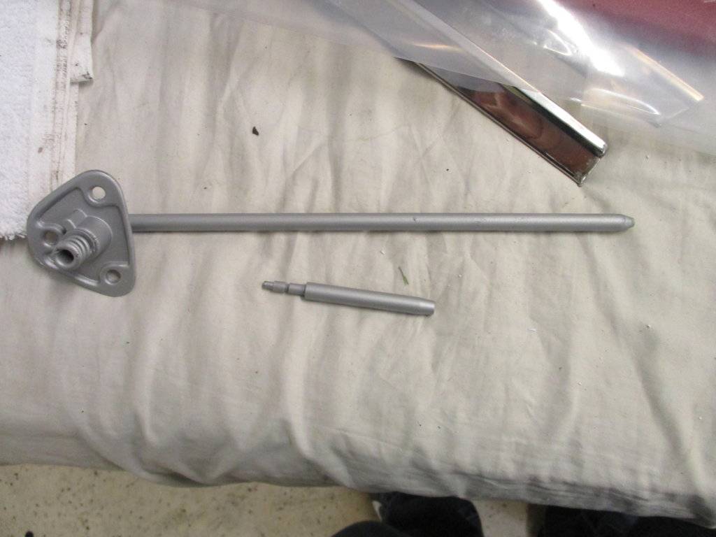

Original visors were redone by Dave Patik...The arms were done by Totally Auto...Original hardware as shown. I cannot find the sun visor tips for the life of me...

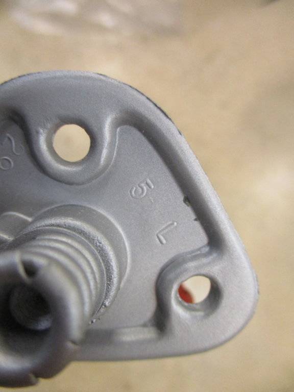

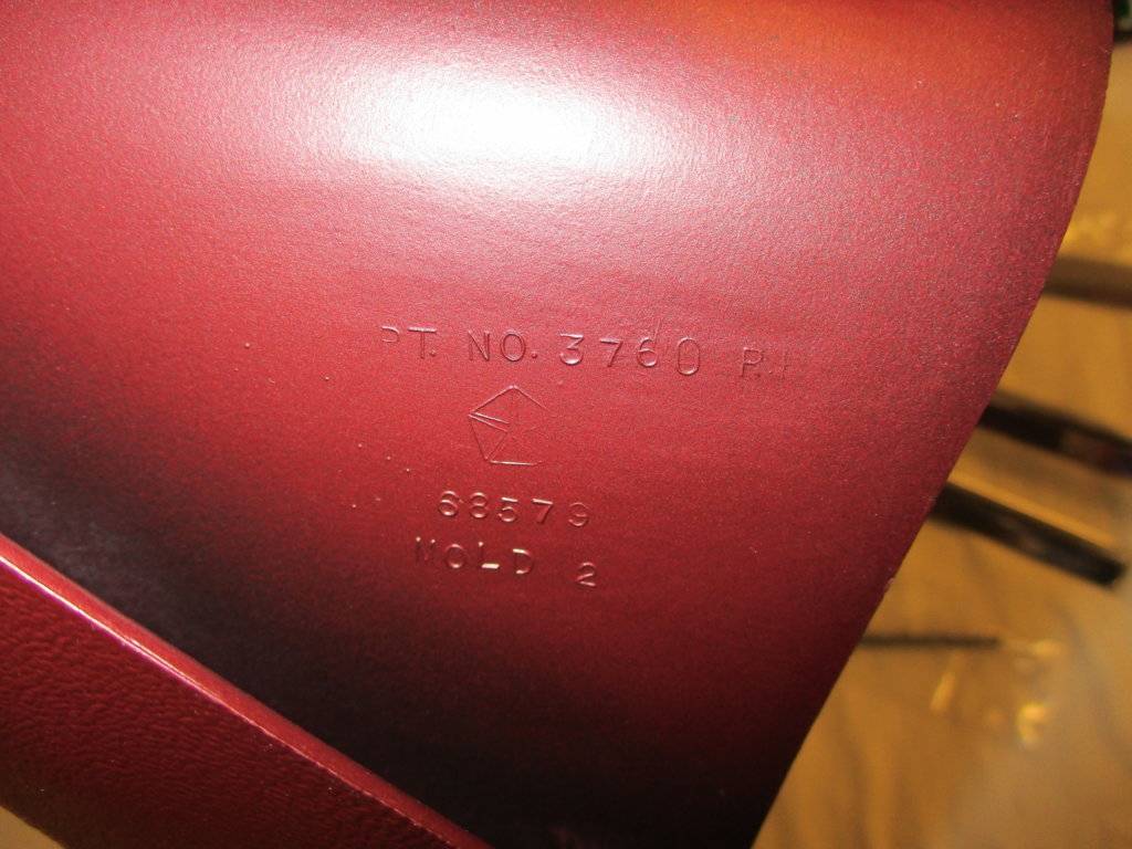

The sun visor arms have a part number and a (R or L) on them....

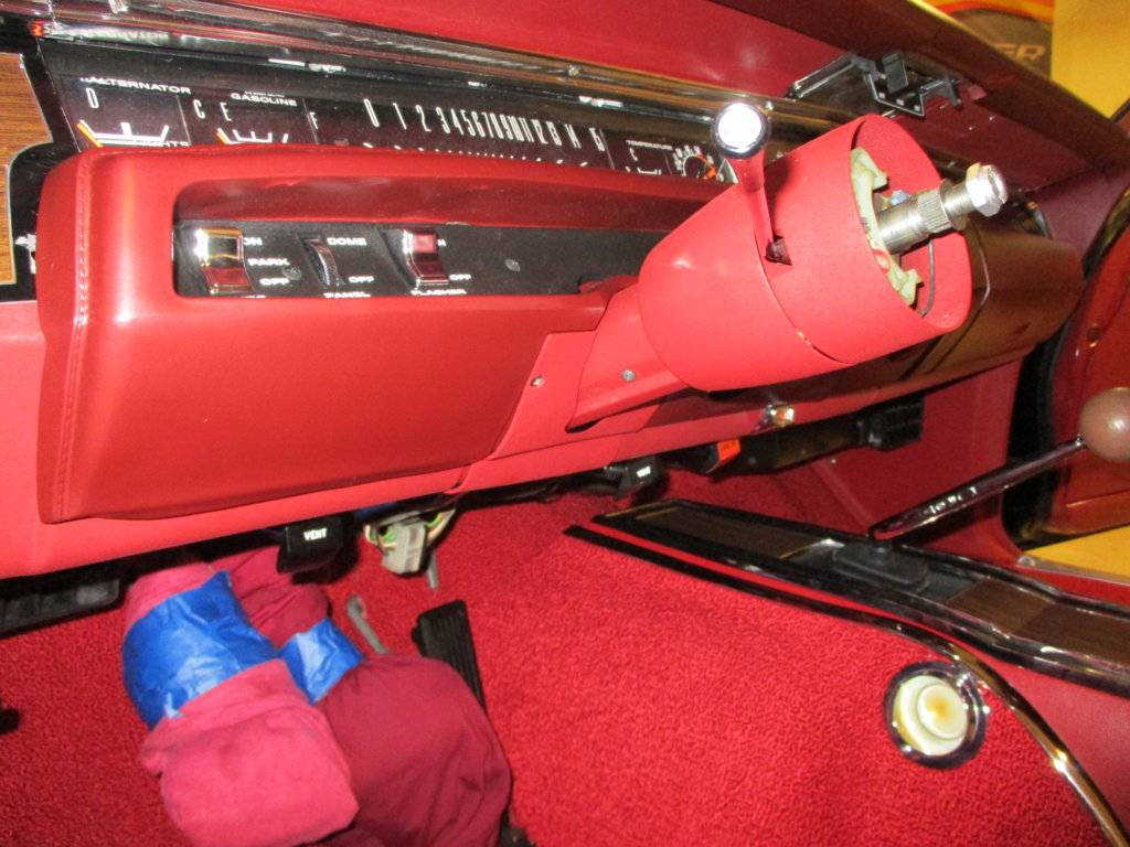

Steering column cover was done by Instrument Specialties....Original hardware as shown....The 2 long bolts is due to the lower dash pad...

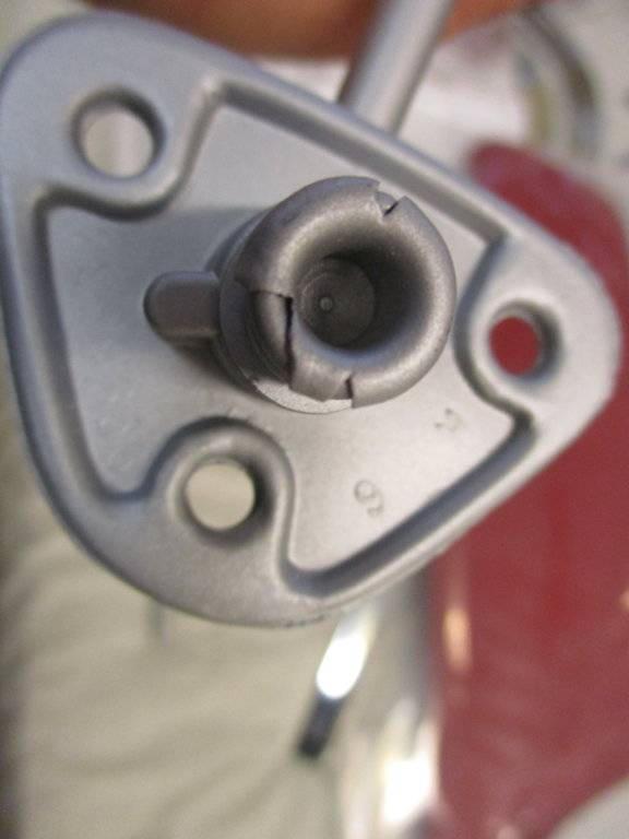

Coat hooks were redone by Dave Patik...

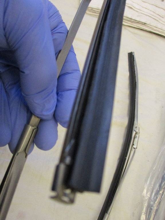

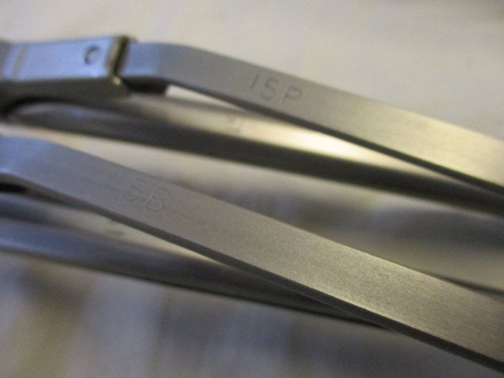

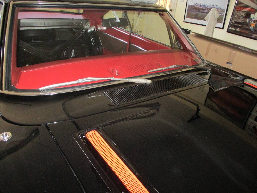

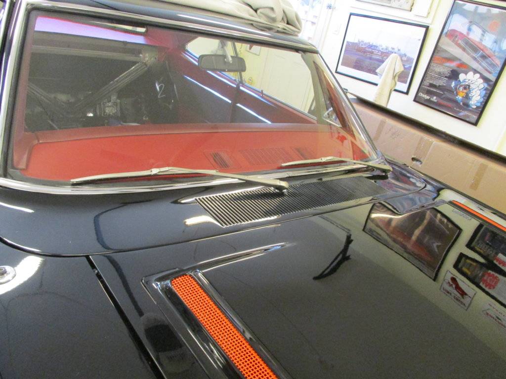

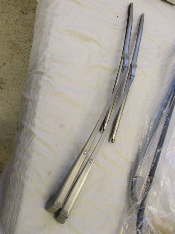

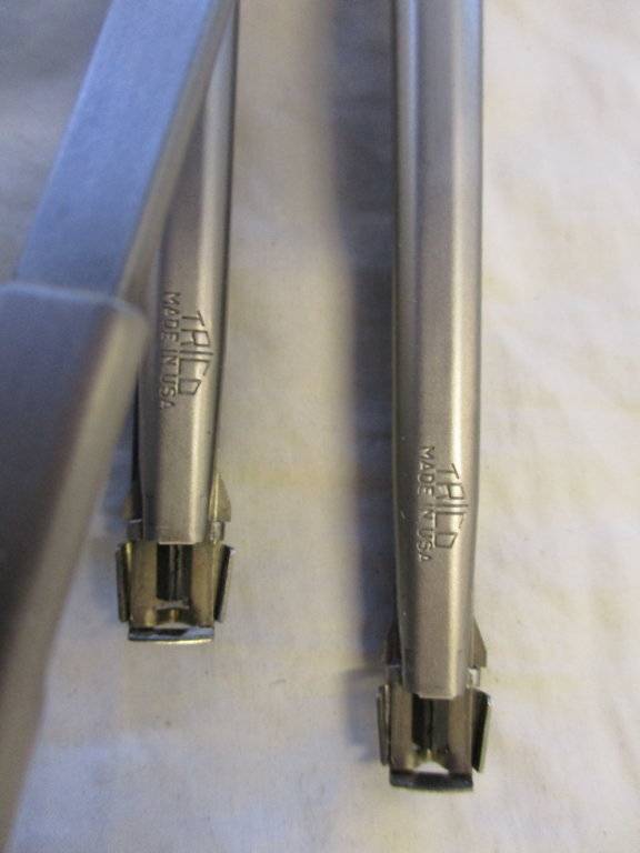

Installed the wiper blades....Notice the correct stampings 15B on the arms. The blade assemblies are the real deal NOS for 69...Notice the ribs on the blade and the Trico stamping..

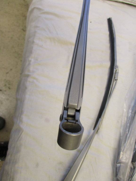

I spent A LOT of time on the arms to get them back close to original finish....More time than you can imagine....For a part most don't even notice unless they are missing, lol....
Also be sure your system is in "Park" before you install them....

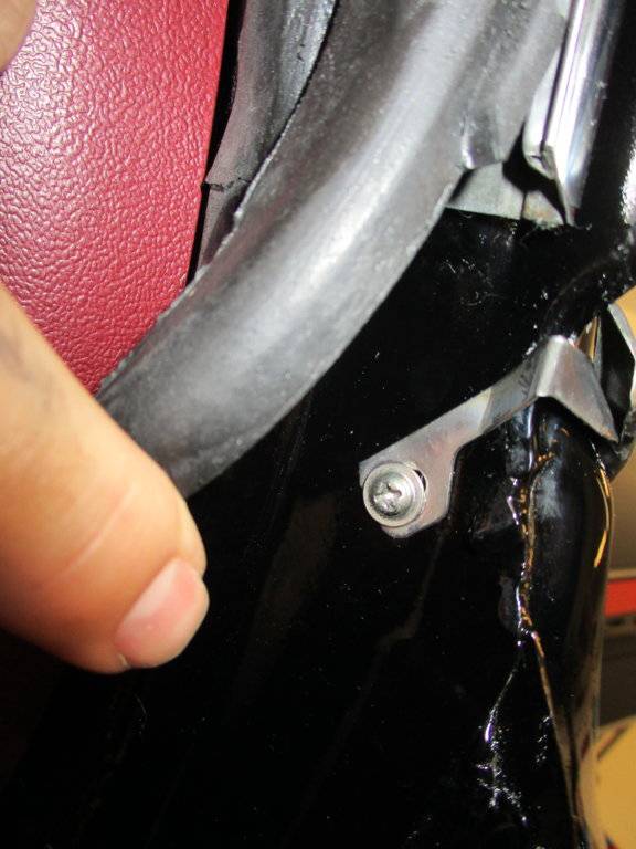

Installed the hardware in the ear piece for the front trim....Then a black adhesive was use to attach the roof rail weatherstrip to cover this...

I bet ya the rt. arm is 1-2 knurls too low,lol...Wet w/shield they move a lot more back&forth. Hey, somebody has to keep you on the path! Jeff
Nope....I cannot stand the wipers sitting up high, Pet peeve of mine.....Thats were they will always stay parked on a windshield that will never see water....lol...
I did do a dry test btw and thats where they always fall in park....Which is probably the last time they will come on.....
Moderators--is there a way we can pick an 'agree','like' and 'thanks' all at the same time?lol.
Never say "never". AND if 'they' hit that gorgeous trim ur gonna be P.O'd.
I guarntee never.....lol....They will not hit the trim btw...I install these the same as all my previous resto's and the daily drivers in the past....It is a fine line but I am above it my friend...
Thanks for keeping an eye out....
