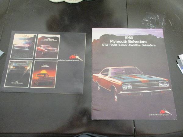

Here are two original 69 sales brochures that will be displayed with the X....

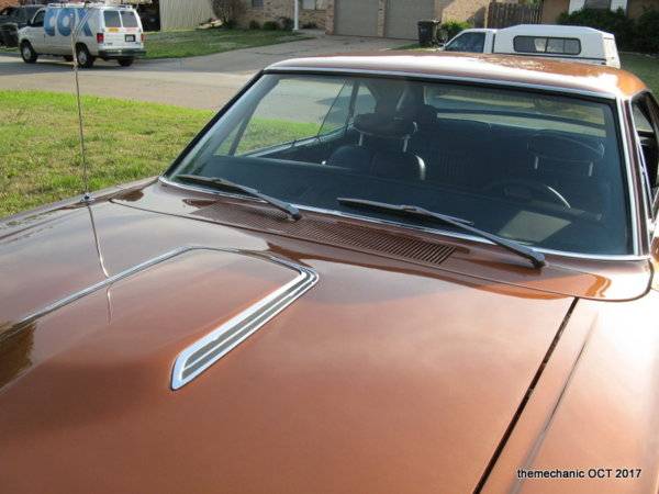

Anyone notice the position of the wipers....hint hint lol.....

LOL I just figured ur problem, sitting too low in the seat makes the wipers seem higher!!!

How did mine look before I took them off for paint?
If you look closely at the chargers above two match yours on the drivers side(because they used them at some point)....the third no one flipped the switch yet...When I turn mine on the driver side lands where yours does and the passenger fall in the same spot.....Keep in mind the driver blade acts as a brake per se....

That is the main reason why people install them incorrectly.....Make sure the inside of the slotted area is clean....I take some oil and rub in that area....
You can be brave and not protect anything or be safe and take an old towel and cut a hole in it and place over the pivot for protection. I bend back the end a bit that attaches and slide on just enough to hold it but doesn't engage the locking tab. Keep in mind that does not mean you can let it go and run to the other side because it can pop off...This is just to see where the blade lands and then readjust up/down as need be....Do one side at a time...
