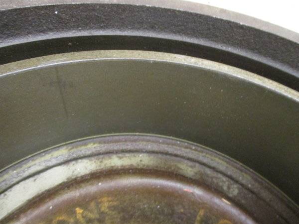

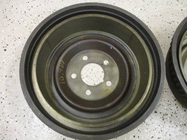

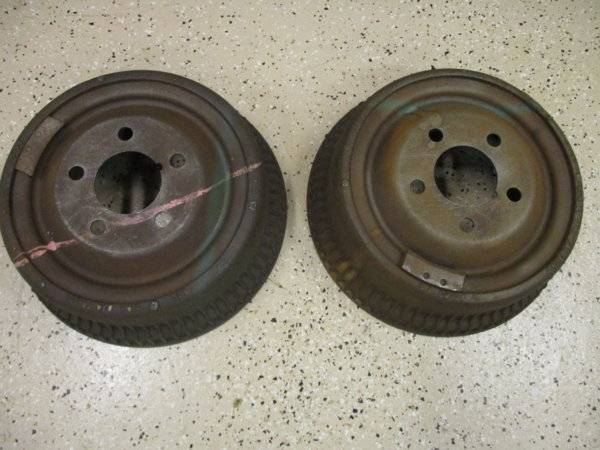

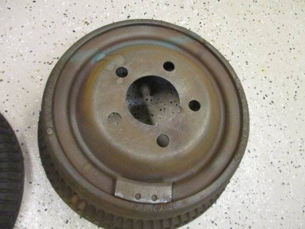

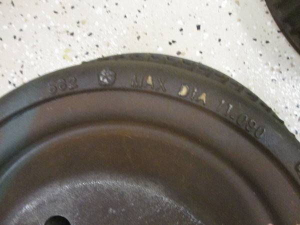

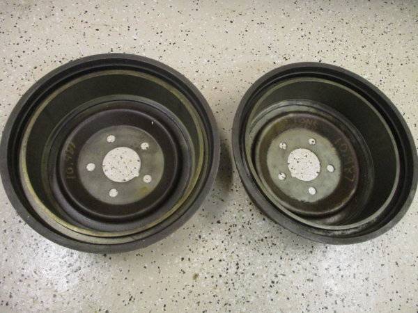

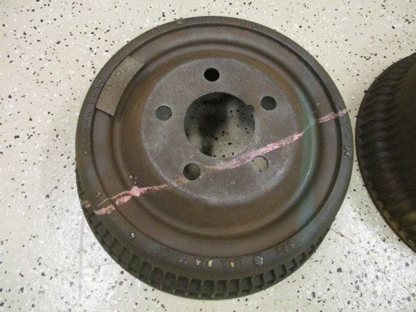

Here is a matched pair of NOS 11" finned rear drums for Dana/8 3/4.....These are to replace the aftermarket new ones on the GTX currently. As far as dating goes these are dated for the year 1972....I have been searching for drums for a very long time. They are virtually unobtainable....Used sets are either pitted, unreadable numbers or are turned....To find a matched NOS pair is unheard of anymore....
To put the OE judging in perspective...If I had a beautiful correctly dated pair with readable part numbers on the car but they are not NOS and have been turned. Points will be deducted and thats just how picky the judges have gotten at certain events.....The part has to be of day one status....Hence, correct date, readable part numbers, and no turning....
At certain events I can get dinged on these NOS drums but I just cannot stand having a cheap aftermarket part on my pop's car......

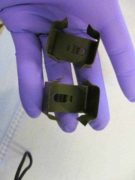

Today I took apart my dash frame and I found one of this on the floor, were should it go and what is it for?

Those brackets house the turn signal flasher and the hazard flasher relays. They attach on the inside of the dash frame on the bottom. The Hazard goes between the ash tray and the column and the TS goes between the steering column and the driver door side.....

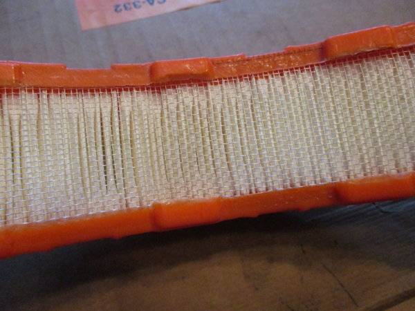

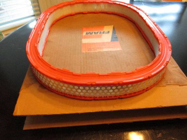

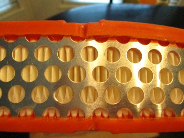

I finally found the closest air filter element to the factory original one. To find an original with PN is unheard of these days. This is a close as one can get. I have a reproduction one and wondered why I couldn't attache the wing nuts. Well, when compared to this very old fram element. My original thought was proven....The reproduction is taller and by over an 1/8"....Not surprised, they cannot even produce an air filter right, lol...The older fram element on the car. Which is the later "black style" matched the correct orange style element...
This rare orange element will only be used when the car is shown.....
