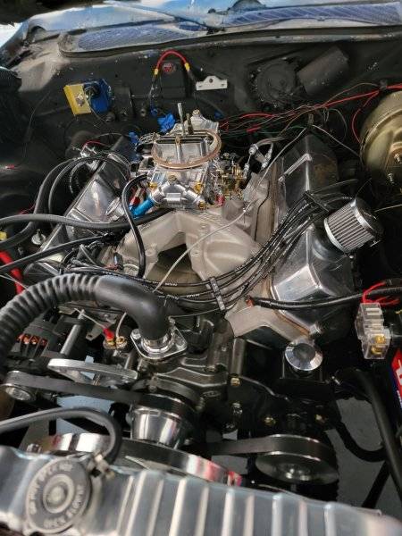

I have a 400 based 512 stroker I just finished installing and the front cylinders (1, 2, 3 and 4) won't fire until the engine is warm. I've changed the ignition box with a spare I have aswell as the coil. Tested spark on all cylinders and I'm running out of ideas and looking for help.
Currently have a holley street avenger on an edelbrock rpm intake. Roller cam with unknown specs.

I notice there is no wiring to or from the ballast resistor....are you sure all the wiring is correct as it needs to be for firing the engine?
Checked the cap, no condensation even tried another cap no luck. I bypassed the resistor during troubleshooting, engine behaves this way with or without it.
