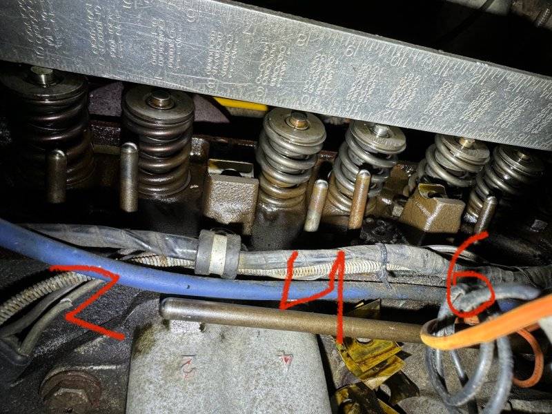

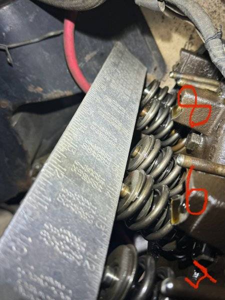

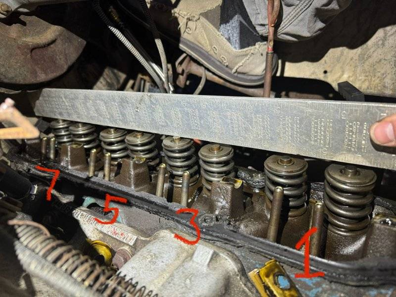

It's all alluding to a possible stuck valve, pushrod fell out, lifter popped up. Side benefit; the other bad cylinder has stuck valve issues. Pull both rocker shish kabobs and check valve heights with a straight edge
Pulled rocker shush kabob and got pics with straight edge…seems awful uneven what does it mean? Seems on the cylinders with low compression the exhaust valves are sticking up higher…

Take a small block of hardwood and a medium sized hammer and give the low ones a few whacks. See if they come up. You might want to lift the valve seal and spray some penetrant od the valve stem above the guide.

Looks like the valves are sunk. Back in the day a shade shop would take the assembled head to a belt grinder and equalize the valve stems lol. But they're pretty out of whack.

Sprayed the valves with pb blaster then tapped all the valves with a piece of wood and a hammer. I got all positive sounding shuts from the valves, the sunk valves did not seem to go up at all maybe a little bit I can’t tell. Thinking that’s the best I can do for now. And will reassemble the rocker shafts and valve covers Friday and see if it runs right. Have a leak down tester on the way to check for leaks in cylinders 3&6.
Your heads are messed up. They need to come off and be rebuilt or replaced.
What makes you think the head is messed up? Maybe just need new valves and an adjustable rocker assembly?
Pnora and rick68b5 are right, those are pretty bad. The seats are sunk
