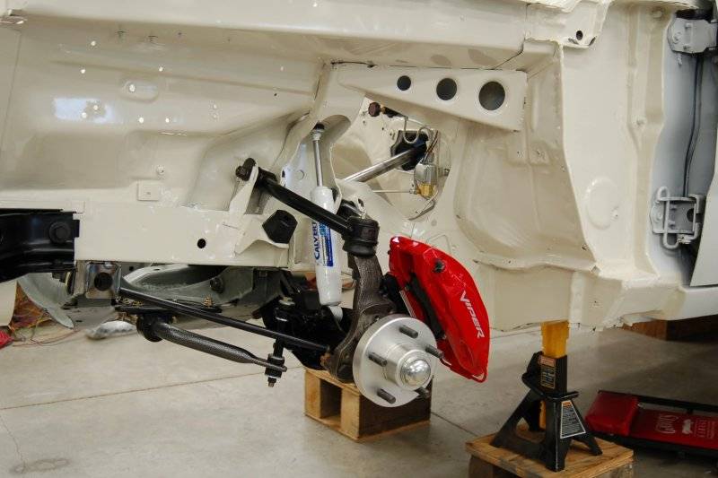

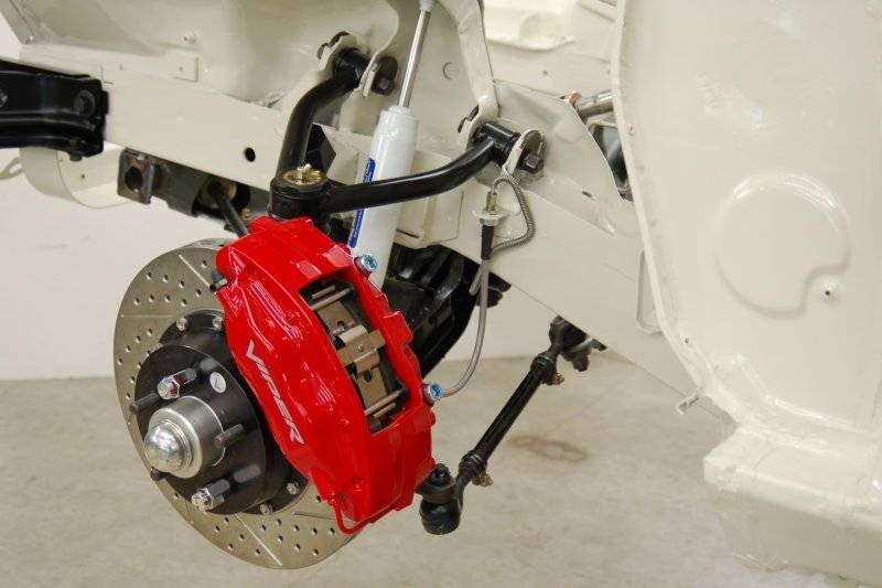

On my last project I used a Viper kit. Looks great, works great and fit nice.
