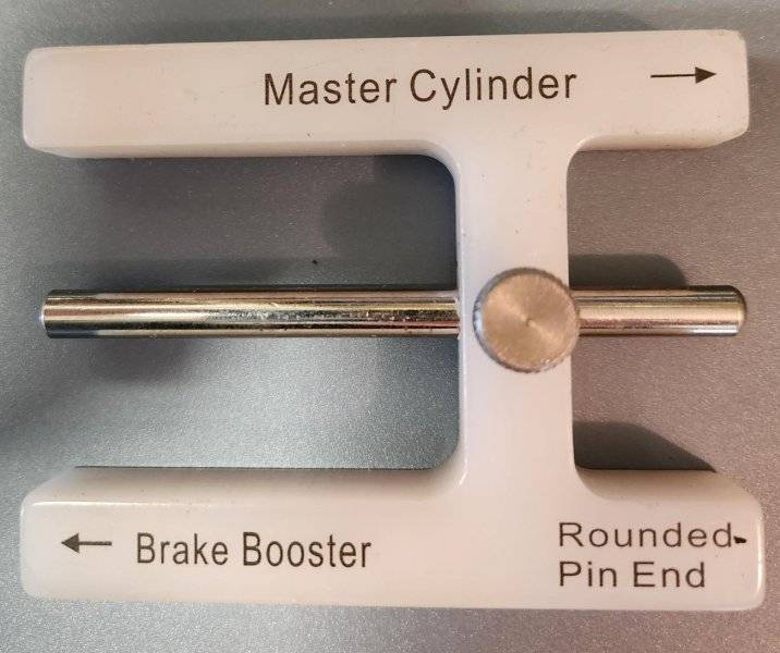

This booster gap gauge is very handy, saves a lot of futzing trying to obtain the measurement. Was your conversion from manual to power brakes? Ask as if it was, there is the pedal ratio adjustment involved. This can involve resetting the pedal linkage connection at the pedal arm. Also if converting from manual to power, the MC bores are non-compatible. Maybe not your hassle.

Booster Gap Gauge
The above tool is an very good one. It takes all the guesswork out of setting the booster pushrod.

Where do you get that tool?
Nevermind they are all over Amazon. So I understand how the system works. Does that mean my pushrod probably isn't long enough since I push the brake pedal down a quite a bit before it really grabs a lot?
