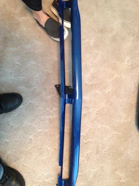

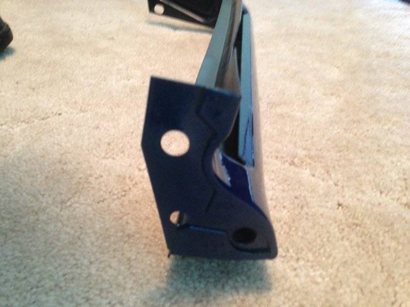

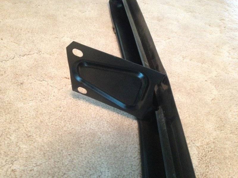

Can someone tell me the bolt size and location for this front fascia? Pics attached. Thanks.

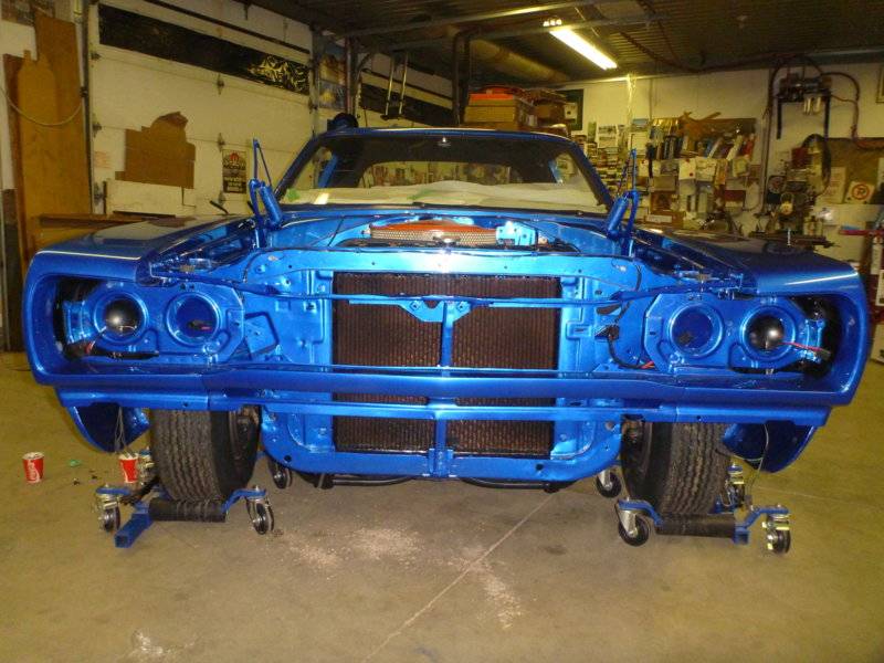

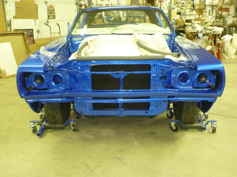

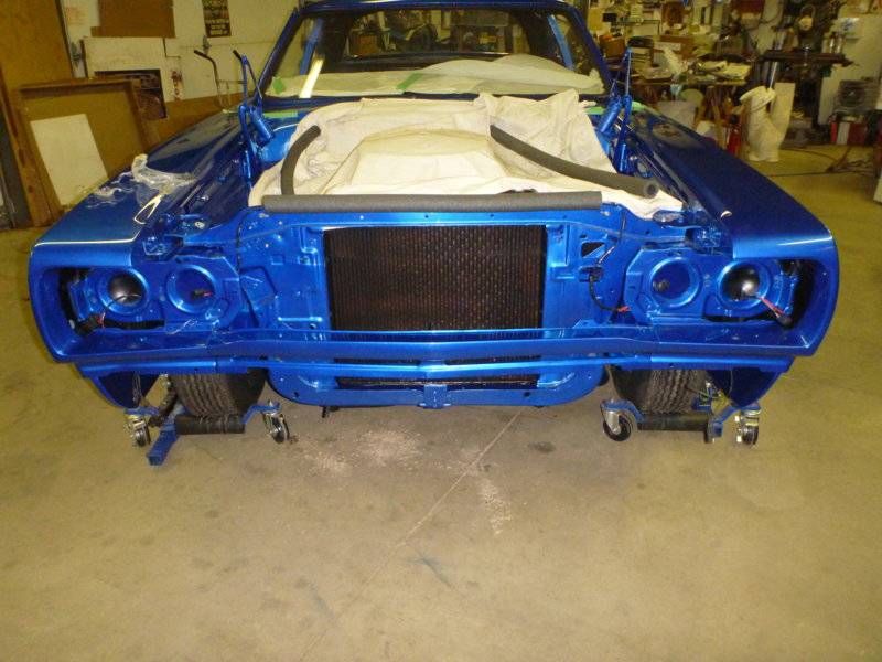

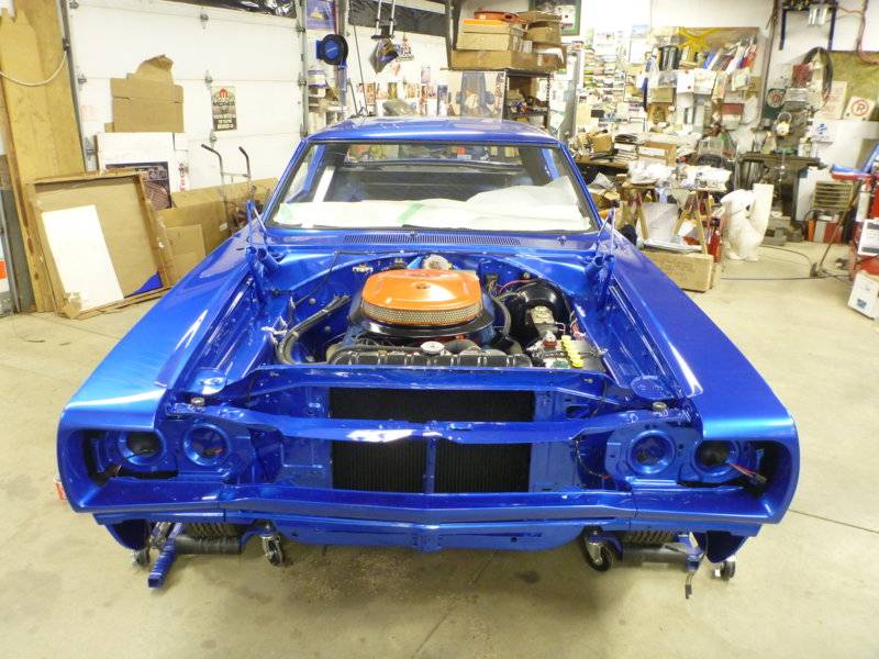

1/4" bolts through the grill support and into the ends of the "headlight bucket" area of the fenders into fixed nuts that are welded there. Probably the only place I haven't stuck a camera, but look at the fenders and you'll know how it goes.
