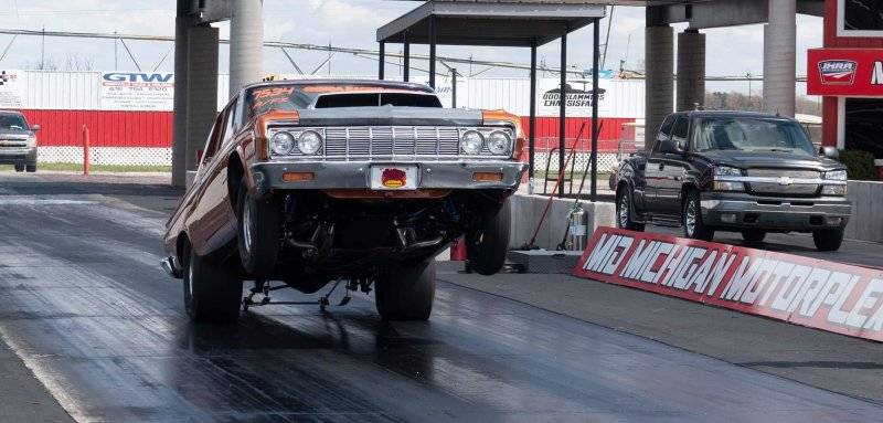

You would be surprised how much you can shorten a strut rod to gain caster. For those of you who think it will bind? It doesn't. I see comments about freeing up the front suspension. In my experience you almost always have to slow down front travel in a drag strip apllication. My drag car has shortened strut rods. Poly lower and poly strut rod bushings. offset upper bushings. 12 years, 1000 passes leaving like this. You have to think outside the box.
Doug
