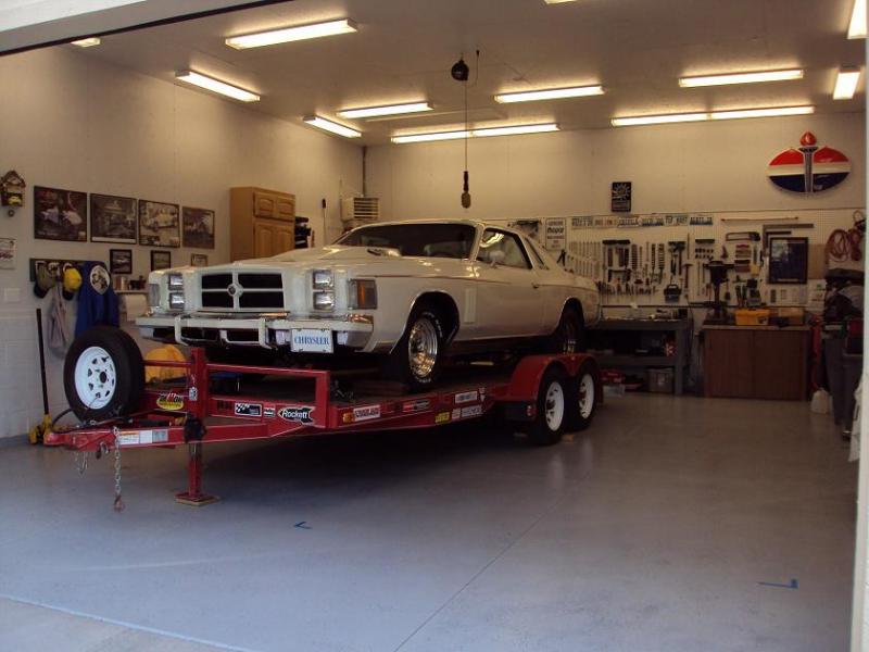

I wanted to stick with the factory aluminum wheels on my 300 ( only weigh 13 lbs each ) and they measure 15X6. MT Sportsman front tires were my only choice with that wide of a wheel.
