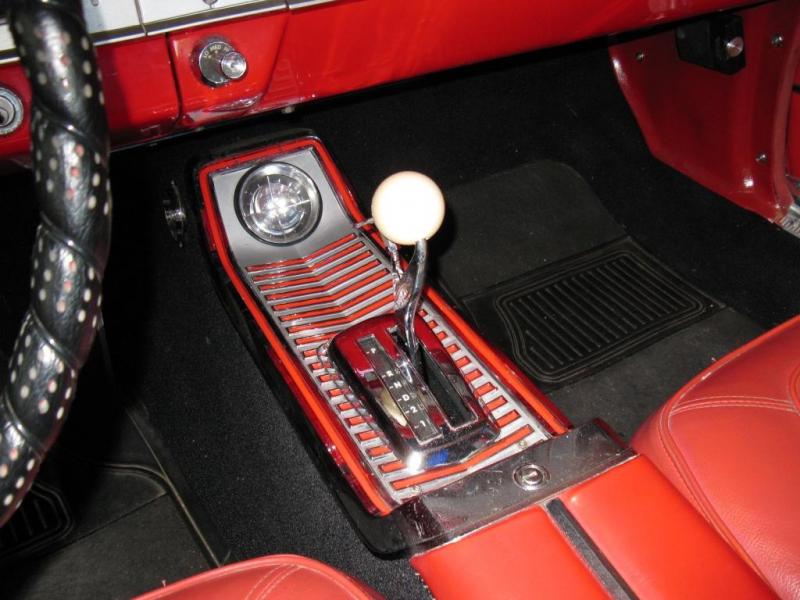

I also love using the Pioneer tune ups...sound great and can mount just about anywhere, top right corner of picture. Yes... if you look hard enough they are still out there. Picked up a set last year BNIB for $60

Beezee is right on with the undercover 2 speakers. They are amazing I find them better than the 6x9s on the package shelf.
I hid all the stereo in my 65 the only thing you can barely see is the tune ups.

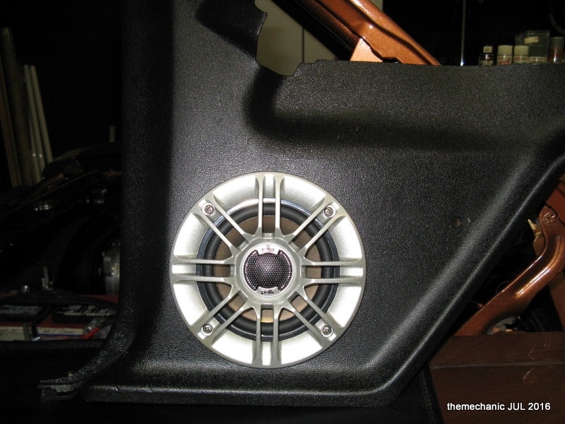

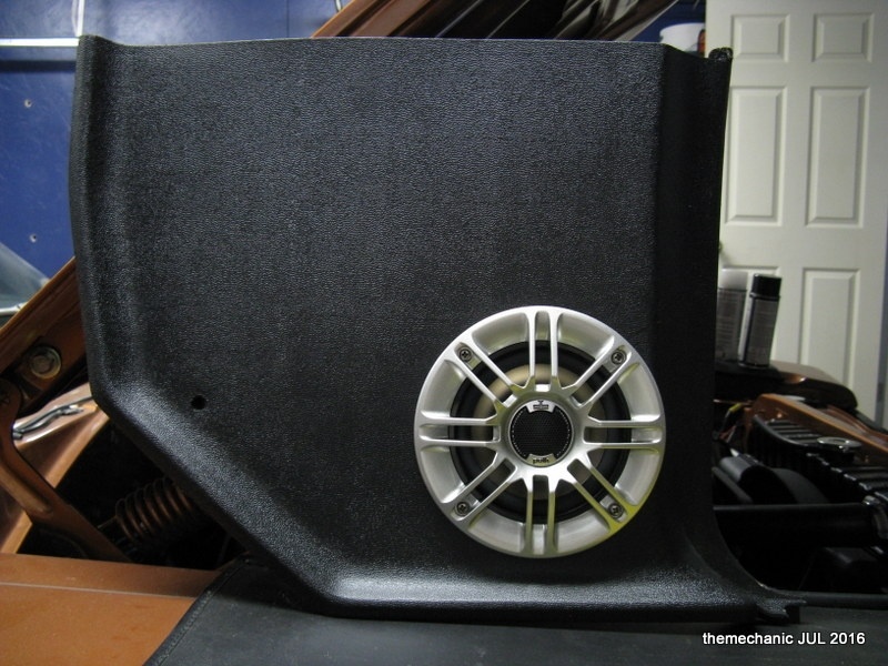

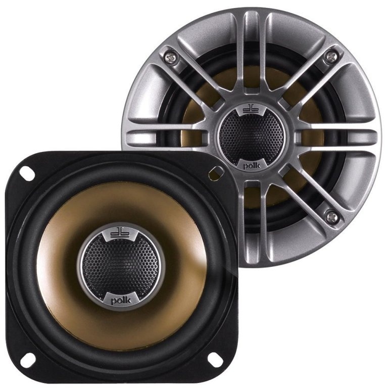

I installed a pair of Polk Audio DB401 4" speakers in my kick panels. They are marine grade. So, no worries about water. I had an old nasty set of panels to test fit; good thing, too. I got it right on the good panels. Just measured 4" from the bottom and 4" in from the edge, drill a 4" hole with a hole saw and install speakers. They overlap the rolled edge a bit but they have too in order to fit the recess behind each panel. There's about 1/4" clearance between the e-brake and the speaker grill. Woohoo!
Here's a few photos:

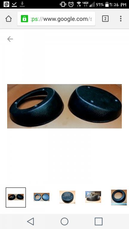

I know you've already purchased your speakers but they (mfgs) also make a shallow mount speakers....I'm sure this has be done in various fashions sucesfully...
