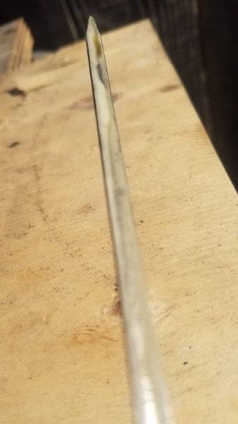

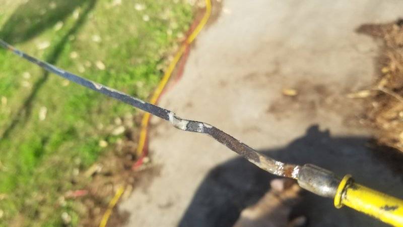

With the crummy weather I'be been driving the car maybe once every other week. Today was a good day to take her out for a spin. It was still cold out, probably 40 degrees. I checked the oil and low and behold I find this congealed milky brown forth all up and down the dip stick.
These two were taken after I wiped up the dipstick and re-inserted it. I wish I had my camera phone on the first run.
When I saw this immediately I thought about a blown head gasket because the last time I drove the car it was smoking a lot (during start up during a cold 35' night).

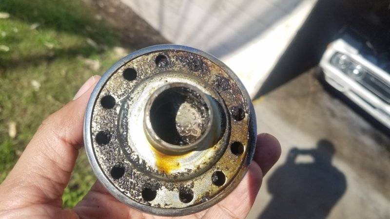

I checked the oil filler caps and crank case vent filter expecting some grodie stuff but it didn't look bad at all:

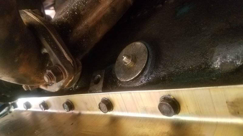

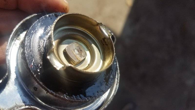

I opened the radiator cap while the car was cold and engine was running and no bubbles. Coolant levels were low though, probably a good half gallon. There have been signs of coolant leakage ever since I started storing the car in this freezing cold weather. The leak went all the way to my garage wall. This is the seep area:
What is that half dollar looking thing? I snugged it up, it was definitely not tight. The metal seems so flimsy I didn't want to overtorque the nut and bend the metal and cause an even worse leak. I don't even know what the thing is called so I can't look up the torque specs :-/
Now that the weather is nicer, like 60'F there is no more smoke at all. I still see that milky froth on the dipstick though, particularly on one side of the dipstick. Car runs fine, no weird noises.

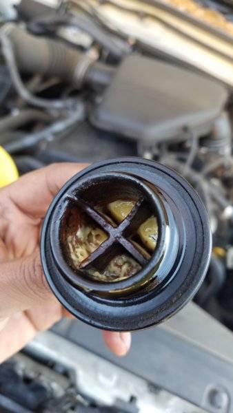

What's funny is that I was doing the oil change on my Tacoma and I noticed the same spooge on its cap. Way more accumulated than on the Charger but the Tacoma dipstick is totally clean. All the oil I drained looked normal.

almost positive you got a leaking head gasket especially with water in the oil (the frothy dipstick tells me that)
That thing on the side of your block appears to be an expandable casting plug. Something one might use to replace a rusty (leaky) original style plug. There is a better adjustable plug available than the rubber ones. I can post a photo if you'd like.
But the plug isn't causing the other problems you've mentioned.
It would've shown up on the low point oil drain test since the coolant would settle closer to the drain plug no? When looking in the radiator and overflow bottle the antifreeze green and clean by the way. I was about .5 Gal low on coolant.
Could it just be condensation from sitting for so long in such a cold climate? *Crosses fingers* The white smoke disappears once the weather is not cold or when I'm driving around at operating temps. Wouldn't I get white smoke all the time?
