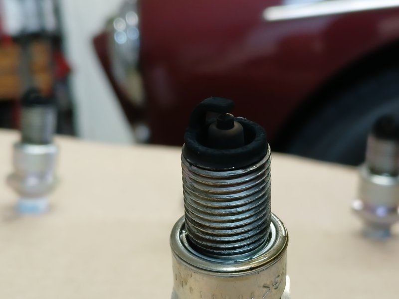

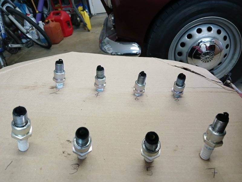

Coolant looks good. Your plugs say you are running on the rich side though (on all cylinders). Have you looked into that?
Long, drawn-out and, so far, failed war with the SummitRacing 8600VS carb on that issue.
David
Care to elaborate? Failed war sounds like a lot of sht has been thrown at it.. Do you have another carb to go back too for testing?
It has always run rich and the right combination of timing and carb tuning has been elusive. I may have damaged the power valve as I did have backfires through the carb at one point. I have a replacement to fit and see if it helps. I've also read that the idle feeds can be reduced with a kit from Summit that may help. After that, it's time to buy a replacement (no, I have nothing on the shelf).
David
Yeah, those plugs look like it is running quite rich.

Plugs out and compression tested.
I think (at least I hope) I cried wolf. If so, my apologies but gratitude for all the advice and support.
Compression test results
Left bank : 1 - 130, 3 - 120, 5 - 120, 7 - 115
Right bank : 2 - 130, 4 - 120, 6 - 130, 8 - 120
So, no milky, yoghurty stuff showing anywhere, no oil showing now in coolant, plugs all equally fouled (see pics below. I need to fix that overfueling) and compression shows no obvious problem except #7 being on the low side.
What do you think, please?
DavidView attachment 1646417View attachment 1646418
Rich, not oil IMO
