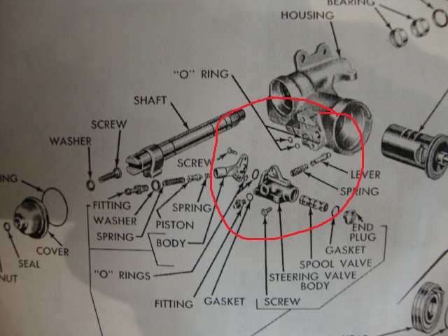

i looked at the '68 b-body manual and there is a a spring and a lever under the valve body...seems pretty straightforward...

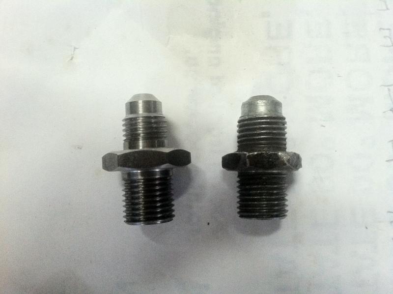

MarPar - Can I ask if you ever got this fitting off? I gust replaced mine when I pulled my engine, was a bear. Also, the fitting you are talking about. The flared side on my original was too large for any standard hose and I could not find a fitting anywhere. One of my buddy's owns a machine shop created a flared one a bit smaller to fit the standard power steering hoses with the threads to the gear box. I am not a thread diamter guy, so I apolgize up front. Posted a picture, you can see my original and one of the new ones my friend created. I have an extra if needed, let me know

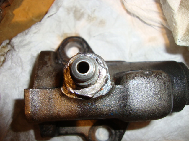

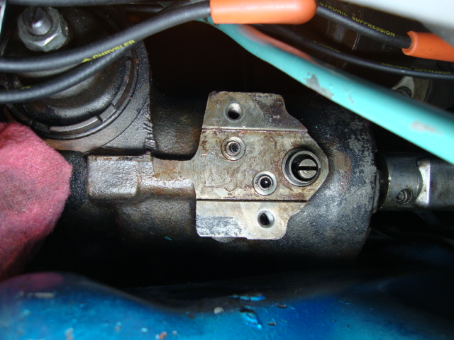

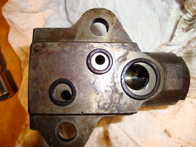

a few pics to jog the memory...
