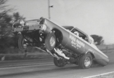

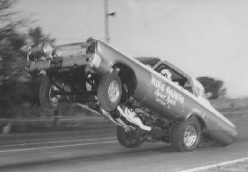

ozymaxwedge...is this the front end lift you were talking about....lol... well that was about 50 years ago when I was just a kid...traction no problem back then..
1) 15" rear altered wheel base
2) front tube axle moved 10" forward
3) Engine set back 26"
Drive shaft was 10" long...lol
Mike
