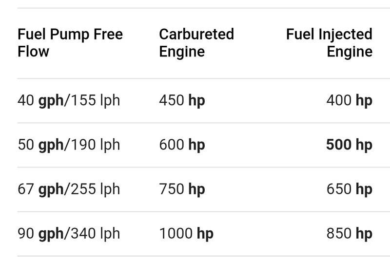

I have a Walbro 255lph inline pump on my 700hp turbo jet boat w 750 double pumper. It is rated at 87psi. The regulator lowers psi to 6 and then boost references it up. Has lasted 6 yrs. For reference, 255lph is 67gph.
