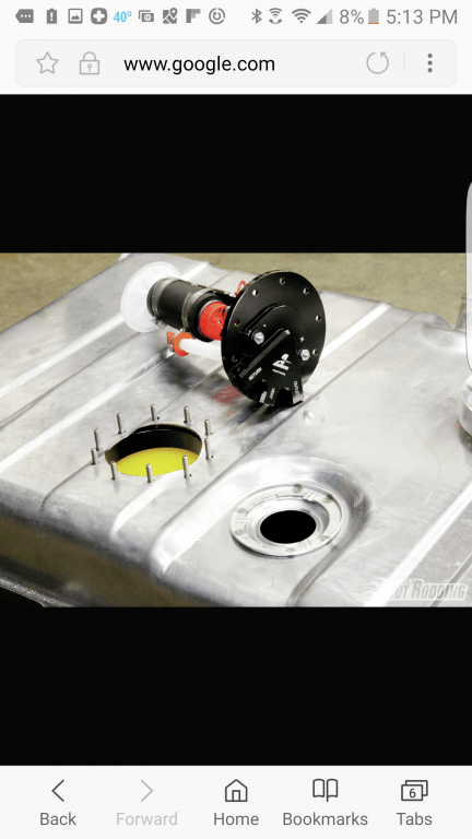

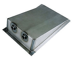

I have a relatively new Holley Blue electric fuel pump mounted on rear cross member right above the stock fuel tank sending unit. The stock tank has a dual outlet mini-sump on it with 5 hole-saw-cut holes in the bottom of the tank under the sump.
My fuel pressure (regulated) is set at 6psi, but I've noticed that every once in a while the fuel pressure (mechanical gage on hood) is dropping to about 1-1/2psi. I have 2 fuel filters. One is mounted BEFORE the fuel pump & the other is mounted before the carburetors.
I read on another post where a guy also had two fuel filters mounted like me, but he was running a mechanical pump (I'm electric only) and also having an intermittent low fuel pressure problem. One member said that he shouldn't be using a fuel filter before the pump.
Is this also true when running electric only? I DEFIINTELY can't go lean running nitrous.

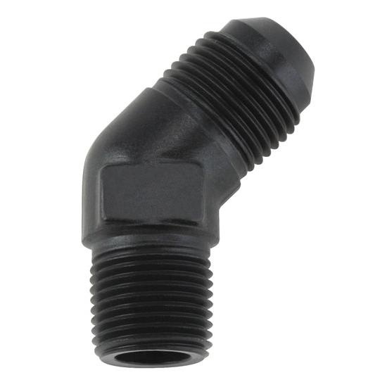

On a related note..... whenever my car goes onto a flatbed tow truck (forwards or backwards) the angle of the car going onto the truck scrapes the fuel line/nipple & causes a massive fuel leak. Anyone know of an angled 3/8" nipple or a hard metal option? I "think" the sump outlet is 1/2" pipe thread, but it might be 3/8"....not sure. THANKS!

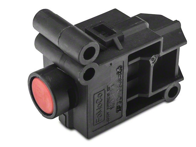

Hmm.... anyone have a good idea of where to put the electric pump on a '70 that's not hanging down below the back bumper? Also, any ideas about how to buy/install a fuel pump cut-off switch? God forbid I get rear-ended & the fuel pump stays on. My Mustang has some type of "inertial switch" in the trunk to cut off fuel in case of a wreck. I'm still running the less-than-safe under-dash switch for my fuel pump (soon to be pumps).

Talking to guys like Don at FBO it's seams they like to see a #10 supplying the pump then a #8 going to the regulator and then #6 to the carb? Makes perfectly good sense to me, 10 because it's not being forced and has to supply the pump without any push, #8 so it can deliver plenty of volume before being regulated and returned and then #6 because at that point it's there and under pressure so nothing is restricted? This is how I'll likely set mine up using a sump like purplebeeper did.

On my wifes mustang I just bought a used inertia switch on ebay and mounted in the trunk. Has a reset button and also doubles as a theft deterent.
If we go anywhere or even when its in the garage I can thump the switch and it opens the circuit...
A lot of people use oil pressure switches, but I prefer the inertia type...

I use both inertia switch from a Mustang, and an oil pressure switch with the pump run with a relay.
