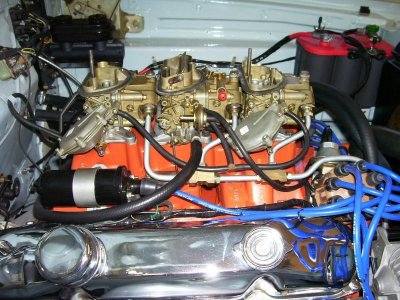

ther's no down side in running 3/8" line from the pump to the carbs. the issue is fabbing one because nobody makes one. putting a filter between the tank and the pump is a no-no unless it's something like a 100 micron screen. here's a pic of a 3/8" 6-pak fuel line i made sometime back.
