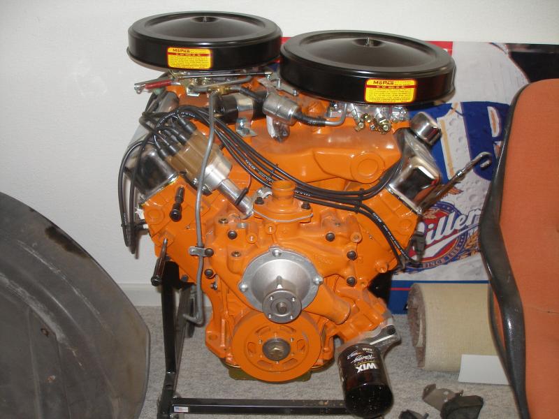

This is Mr. Dale Reed with my Max Wedge (440 build-up)
Call him.
