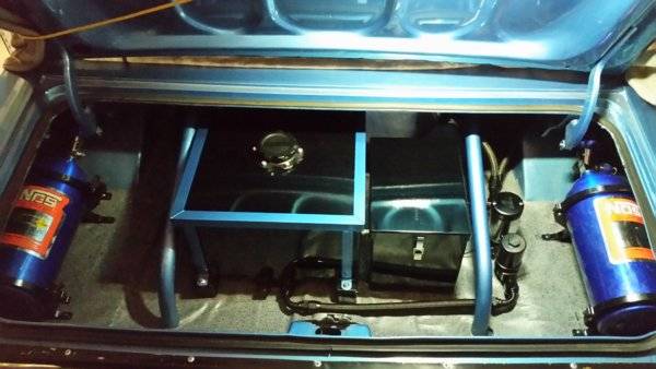

I went all out with the Aeromotive A3000 Fuel Pump. It will be enough to support on motor & with the additional NOS Kits.

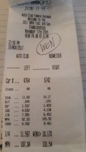

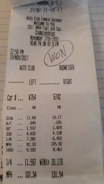

If you plan on doing any hardcore Drag Racing with the Car, Magna Fuel is really great paying Contingency Money. You just cant beat their Pumps and regulators. Great people to deal with.
My 10.170 @ 131+mph 3800 pound Coronet 505" uses a very common Holley Black Pump (non-return style pressure regular) At 7.5 pounds of fuel pressure. 1050 Dominator and 3/8" metal fuel line from pump to engine compartment, then 6an steel braided to regulator and up to Fuel Bowls, really nothing special.... Must work ok...going 10.170 to 10.190 and very consistant on those ET's. I am happy with it.
The motor made 602hp on the engine dyno when first built but I have made a LOT of upgrades since then. I figure it has to very close to 750HP now to push my car to the 10.170, 131+mph time slips.
I would love to have a big time pump, filter and 8 to 10an lines but it is not in the budget (yet..lol).
