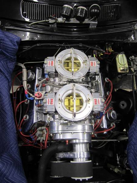

MC, a-1000, aeromotive, .5 line to the front, areomotive regulator,(the one that looks like a red and black minion) .375 lines to the carbs(2 750 eddys), plenty of fuel to go around. Dave.

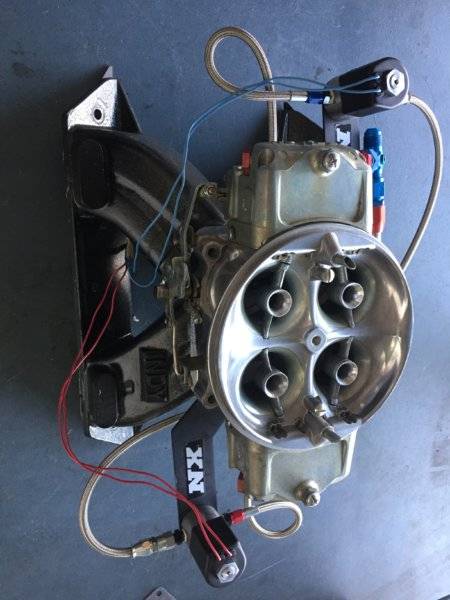

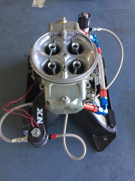

Mopars don't use Nitrous, plain and simple.
That is because most already cried & complained how much money it cost them to build their engines so they don't want to take a chance to hurt them. If tuned right you can run them forever on nitrous & not hurt anything. I have a lot of money tied up into mine and we are still spraying it.
