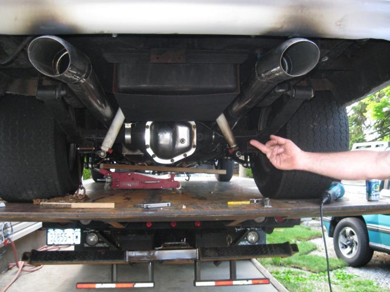

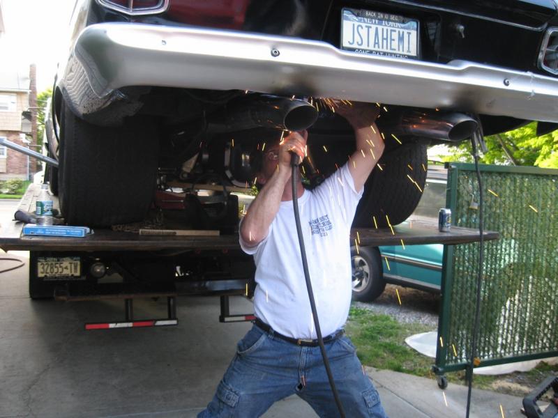

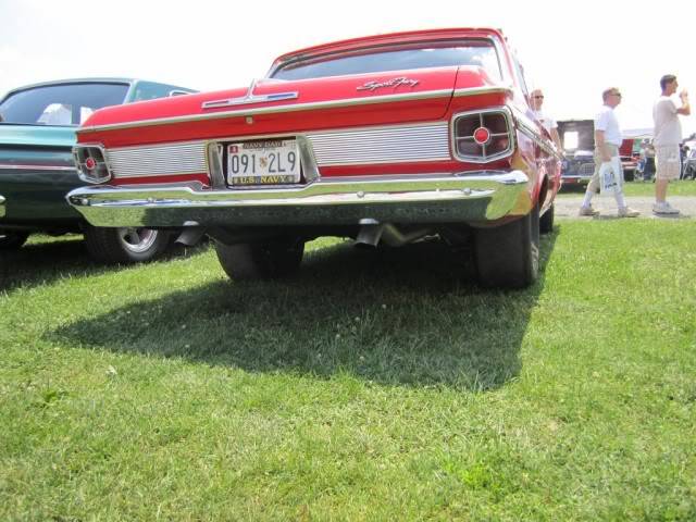

I bought the TTI 3" X-pipe system and not the Max Wedge system as I have no cutouts on my car. I use the Dyno-Max Ultra-Flow mufflers also and you can see where my tailpipes end here. I did that because they say the X-pipe gives a tad more hp and I did not want cutouts as this old man is to lazy to crawl under my car at the track to uncap the cutouts. I really think this system works good and would be surprised if I was any more then a tenth faster uncapped if that. I really like this setup as it sounds good and seems to flow good. Ron
Not a good pic but if you look hard you can see my X-pipe. Ron

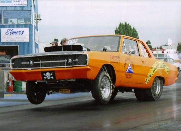

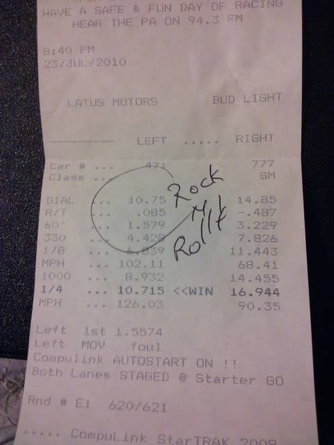

My 67 Dart.
446
tti's headers
Runs 10.71 threw the exhaust and off the juice
The exhaust
The headers
That being said.
My race car did gain a .10 of a second taking off the exhaust

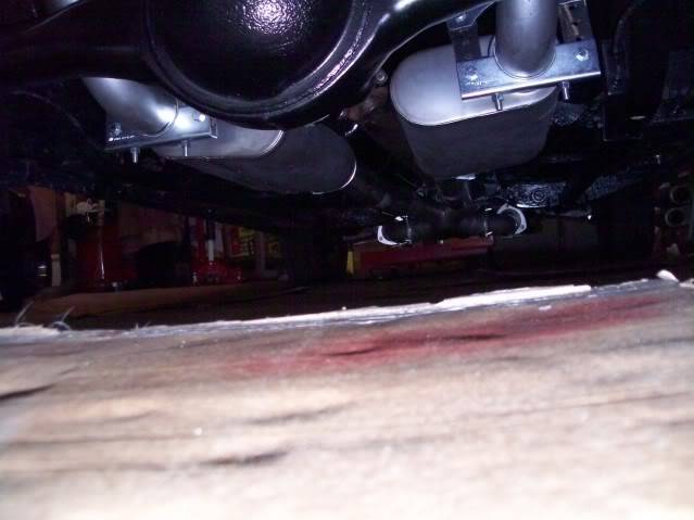

I might have a little more HP than the average.I use a 4 inch pipe off a 4 inch collector into a 4 inch "X" pipe reduced to 3.5 at the Hooker Aerochamber mufflers back to 4.5 and tailpipes out the back bumper.Even if I picked up a tenth or 2,it would be from the weight loss.It's alot of work to remove.I'm more street than strip,so I just leave 'em on.You can't hear my car in the burnout box next anything with open headers:blob1:

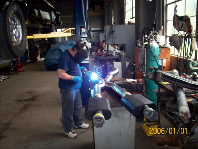

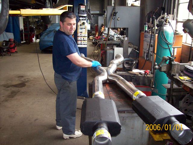

I've been calling around to muffler shops and no one can bend up a 3 inch. I guess these shops dont have the equipment needed.
