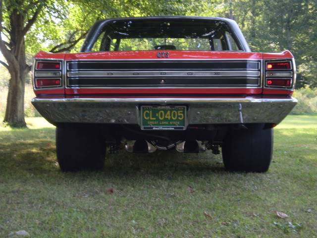

i've never had a car yet that runs the same ET's as uncapped. my Dart is close, it looses about a tenth and a half with the mufflers. and there are not what i would call restrictive at 4"

my pipes are not that heavy... :icon_wink:
