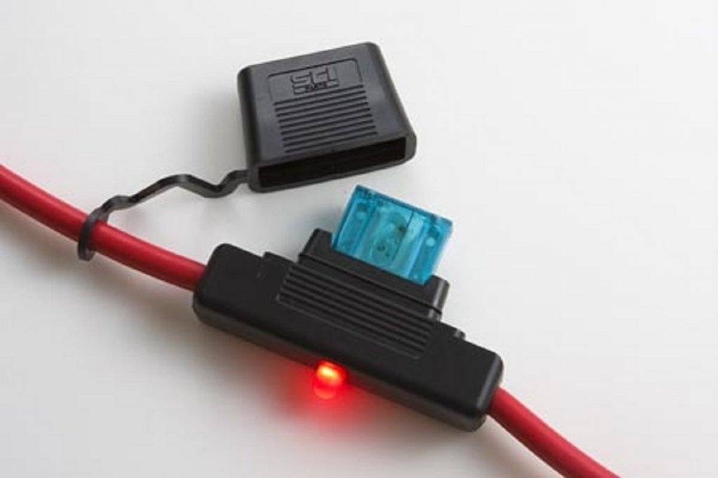

I look at it like this... would you install a fuse in your home that in order to blow it had to literally BURN in half, I think not. Yes they've been used for years, yes they work and yes under the right circumstances they can start a fire. I use the single fuse blocks myself, they're fairly small and can be mounted just about anywhere.
Definitley beats splitting a loom,yrying to splice two ( or more when it melts!) burnt wires in the middle of nowhere, as said earlier, **** happens!
Thes are unobtrusive and easy to service.
