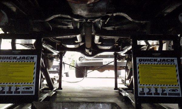

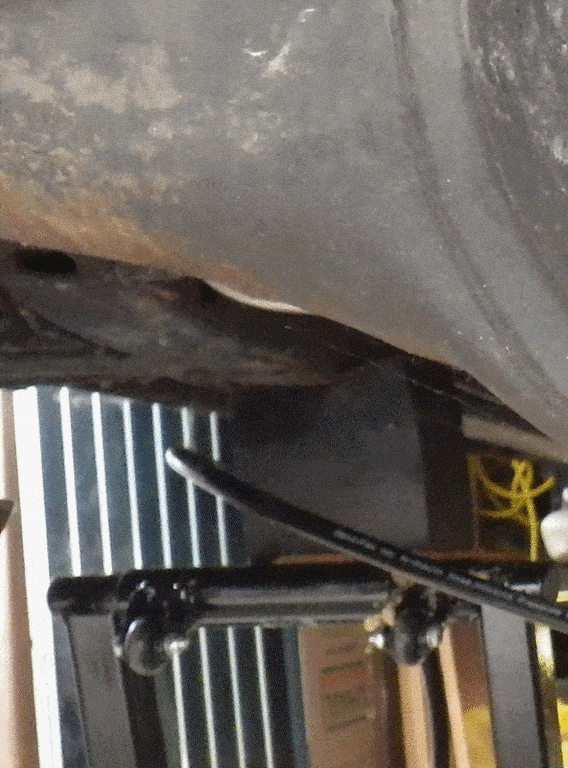

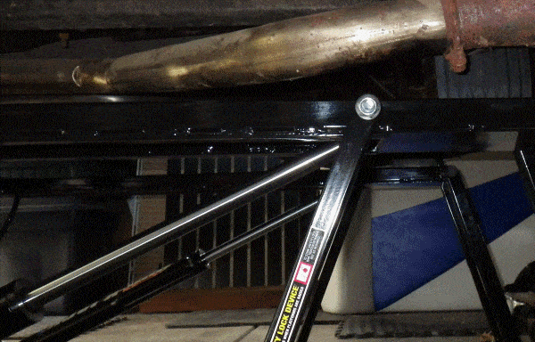

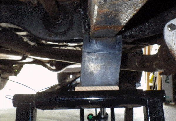

So you know this car is 2 X 3 connected. I'm lifting just forward of the trans cross member and inboard of the rear torque box. I need to make adapters to accommodate the exhaust so I'm planning to incorporate some length extension while I'm at it.
These are my "first time" lift pictures. Some learning was needed.
The skimpy rubber blocks they provide don't impress me, Lol, especially when stacked............
Love this portable lift, roll it under the car and lift. Worth the money I think this one was 800?

ya, those rubber blocks do not inspire much confidence. lol
I took two lengths of 2x8's 8' long and put them on top of each lift. raised it that way and it worked pretty well, but im still kinda shaky on the whole deal. dont want to drop my baby into the wall or worse yet, the Dart that lives next to her.

I like the mid rise scissors height and they had me interested, but I really felt a complete open area down the center would be more beneficial to me.
I didn't know anyone with one to ask about it. How's that area working out for you? Any drawbacks?

Don't forget, you can turn these 90° and lift a car that way.
I gave mine a really good shake as it came just off the floor in those pictures and I was surprised how stout it actually felt. Eliminating the thick rubber block and the 2-by for something solid and longer is in my future.

So far I haven't had any issues with it
