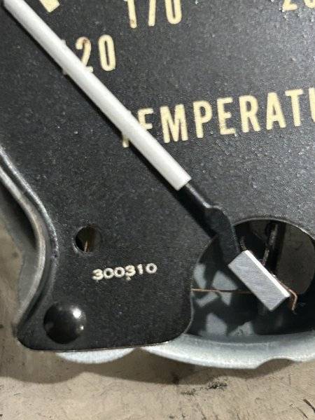

Is this little hole in the temp gauge for adjustment purposes? There’s a brass tab right behind the hole that connects to the brass strip going to the temp needle.

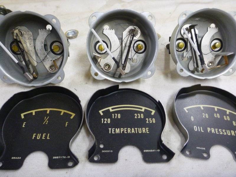

From the pix of the 3 gauges, looks like the only possible adjustment on these gauges is from the small rear hole where you see the teeth.
This makes sense now that I see the internals. My oil pressure is off slightly compared to the Autometer gauge I’m running too
