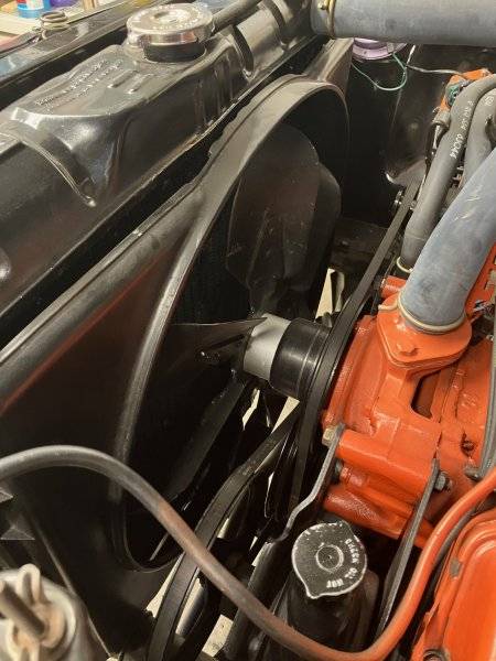

My 22 uses factory 7 blade no clutch and shroud and still doing good but I had shop add another row (3 ) up from 2Also in Florida here, so I'll have the stock fan shroud, wetter water, cooler running water pump, still trying to figure out radiators but would like stay with a stock appearing 22" (feel free to recommend based on your experiences), and has a 50 year old flex fan. should I go back to a stock fan with fan clutch? I'll also be adding Classic Air which it doesn't have now.

Unfortunately stock rad was swapped out for aftermarket - highly original car. Is that the stock shroud can you tell?If you're concerned, Perhaps get the radiator boiled out and rodded, to restore it to original efficiency. A common job we had back in the garage, once done, vehicle back to operating as usual. If not already equipped, I'd recommend a shroud.

Glen-ray for radiator, throw out the flex fan, use factory fan & clutch.Also in Florida here, so I'll have the stock fan shroud, wetter water, cooler running water pump, still trying to figure out radiators but would like stay with a stock appearing 22" (feel free to recommend based on your experiences), and has a 50 year old flex fan. should I go back to a stock fan with fan clutch? I'll also be adding Classic Air which it doesn't have now.
Not the stock fan or shroud. It is better than none but IMO a thermo clutch 7 blade fan would be an improvement even with that shroud.Unfortunately stock rad was swapped out for aftermarket - highly original car. Is that the stock shroud can you tell?
Thanks. Will go through Glen Ray at some point. Knowing this helps.IMHO, not original, doesn’t look quite deep enough.
Thanks for confirming. Have intentions to get Glen-ray to build one. Ultimately that’s the longer term solution I believe. Appreciate you weighing in.Not the stock fan or shroud. It is better than none but IMO a thermo clutch 7 blade fan would be an improvement even with that shroud.
That looks like original fan and shroud to me. Looks like my 70 GTX 440. That is a factory 7 blade fan without a clutch just like mine.Unfortunately stock rad was swapped out for aftermarket - highly original car. Is that the stock shroud can you tell?
First roadrunner and was a little surprised the shroud was so shallow?Im sure there is one but not sure of the engineering reasoning?That looks like original fan and shroud to me. Looks like my 70 GTX 440. That is a factory 7 blade fan without a clutch just like mine.

When we did my motor as mentioned it was 30 over and 11.5 cr prior a stock motor and 2 core was great but the new configuration caused temp rise hence the factory rad 2 row getting recored to 3 and back to 180 temps. Food for thoughtFirst roadrunner and was a little surprised the shroud was so shallow?Im sure there is one but not sure of the engineering reasoning?

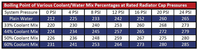

I certainly wouldn't be complaining about 205! Water boils at 212 with no pressure cap.
And every pound of pressure raises the boiling point 3°. A 15# cap raises that 212° to 257° at sea level. The pressure cap, altitude, and coolant mix adjusts those temps but not by much.

For an example, even if you only have 1/3 of the coolant with anti-freeze and are using a 16 psi radiator cap, you won't see boiling until 260 degrees.
"I saw 200 on my Factory gauge. I'm overheating!"I see these posts frequently and sort of shake my head....
You may not realize that the factory gauges were not necessarily built with a NASA level of accuracy.
Even so, look at the following chart:

I do find these temp conversations - which are very common - a touch interesting. In this post and others, folks keep referring to the boiling point as the measure of "overheating". That implies once it boils over, you've overheated despite the actual temperature (i.e., related to pressure, fluid types and mix, etc.). This seems a bit counterintuitive.I see these posts frequently and sort of shake my head....
