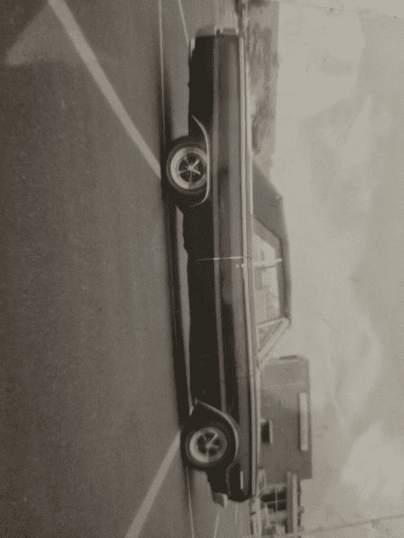

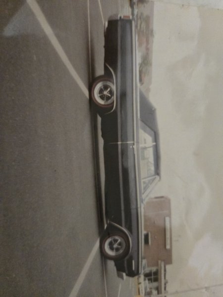

Yeah, the radiator stuff is important but more importantly, you have a really effective parking brake to leave the car like this:
