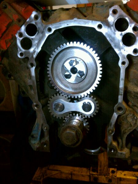

Ive got one, love it, will never go back, and youll never have chain stretch. and make sure you find a good one with needle bearings not brass bushings on the rollers..
And read the directions, it explains to you how to make it fit under the stock timing cover. theres pins that the two small idler gears spin on, and there machined long so you can message them down to the correct lash
