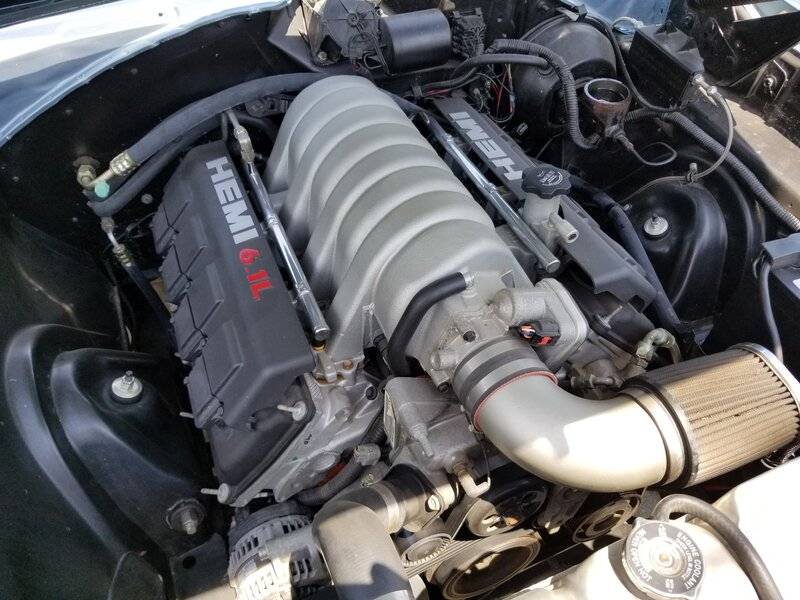

Will a 727 pushbutton T/F from a 318 Poly, bolt up to a 3rd Gen Hemi? I understand the later LA small block T/F will, with a different flex plate, but what about the earlier trans?
I am thinking about swapping my poly out, in the future, but want the push button shift.

I would suggest replacing the reaction shaft support (back half of the pump), pump gears, and input shaft. That will allow you to use any later converter (67 and newer nonlock-up) . It's pretty easy. I can do them in less than 30 minutes. You'll also need a spacer as the Hemi crank length is different.
