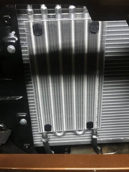

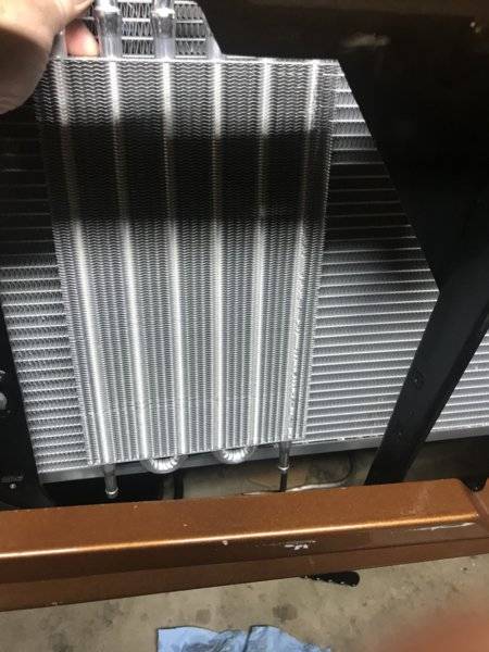

Installing the oil cooler. Then need to figure out if the transmission has neutral on not. Also, I think it’s only hitting 5 of the 6 selections on the trans. The new linkage bracket may be hitting housing, so I may need to make a little clearance. Probably have to pull the pan again to put the endoscope up by the selector, is it called the “comb”?

Installed, little victorys. now on to pull the trans pan, again.

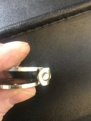

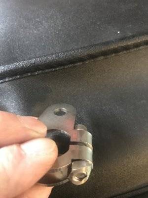

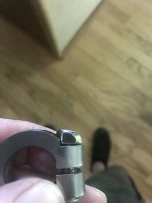

Had to run to my brothers to have him weld the nut to this bracket. It kept turning when I tightened it, so the rounded part wasn’t facing the trans housing. This was making it so it wouldn’t shift fully into park. I still may need to clearance the housing a bit too.

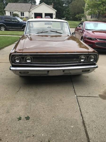

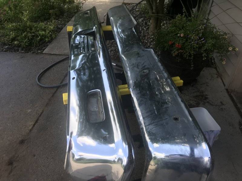

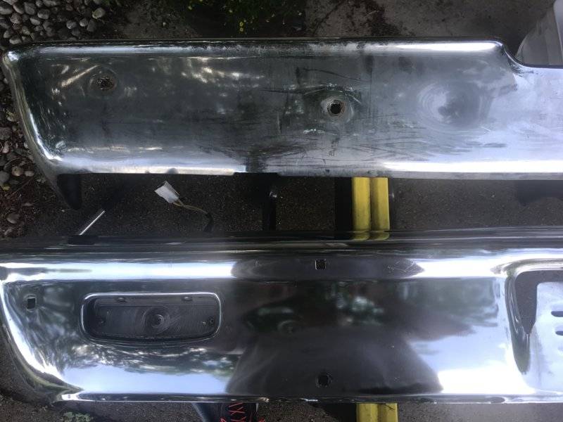

Finally drove the car in the neighborhood last Friday for the first time. Trying to get these old bumpers cleaned up now. Not the cars originals, but decent for now. Front is cleaned, getting ready to do the rear, needed a short break.

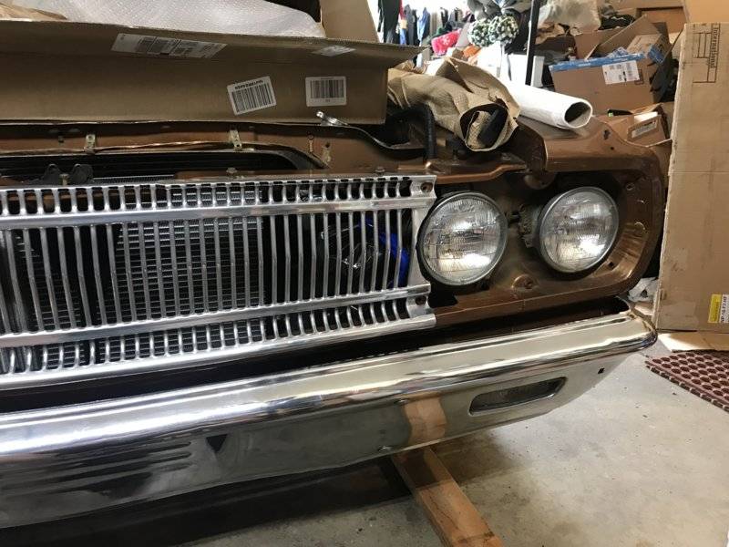

Got some exterior stuff on. Need to check lights out and still needs an alignment.

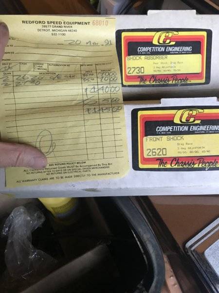

Cleaning out the trunk, looking for the seat belt stuff. Ran across the shock boxes of the shocks that came with the car. And the old receipt. Some of you south east MI guys probably know this old shop. Maybe it’s still there?

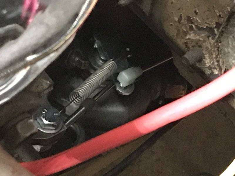

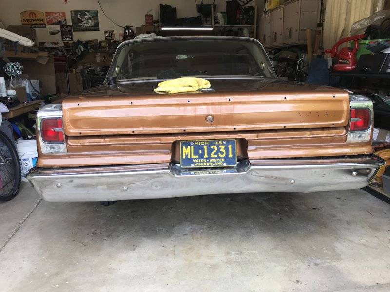

My brother picked up my car Tuesday night. Wednesday he adjusted the new kick down cable then had to make a new bracket for the throttle cable. Once the kick down was setup the throttle only opened 1/4 way. He made a couple other minor adjustments and fixes then took it to the alignment shop. No word Until Thursday afternoon. Texted me looking for specs for the used QA1 UCA & LCA that I installed, making sure they were right for the car.
