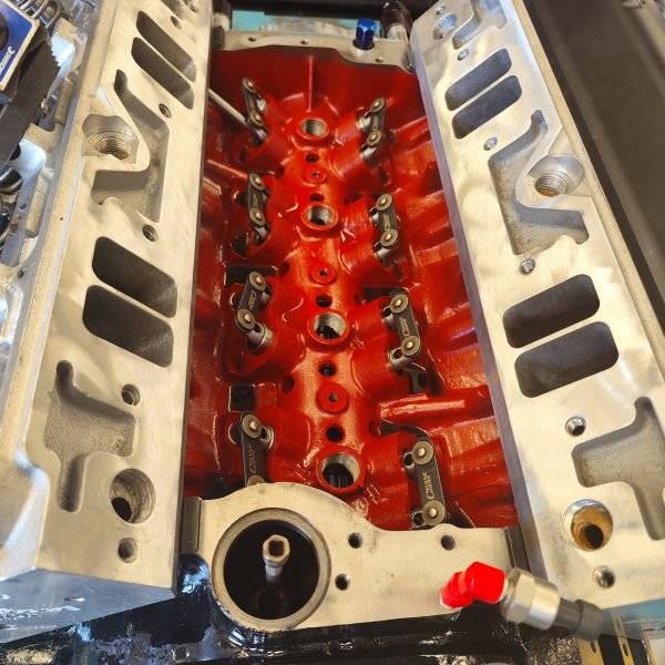

I changed an intake the other day and re-found that old glistening Glyptal Red valley staring me in the face. I forgot all about that stuff. This is in a .060 over 68 440 HP short block that I got for $100 many years ago. I just put some heads on it and dropped it in a car and still run it today.
It leads me to a curious question - does anyone use this stuff anymore? It seems that the debate over its effectiveness was always a topic of discussion.

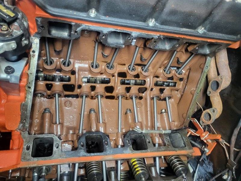

No doubt. Whomever came before me must have prepped it right. 30+ years soaked in oil and all those heat cycles over the miles and it still looks brand new.
