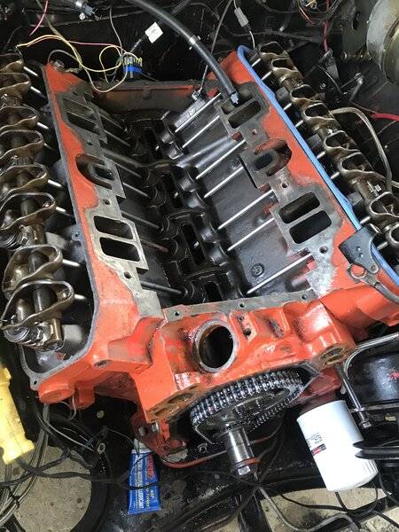

Ok I think I figured out why the lobe got hammered. When I pulled the oil pump shaft out I noticed that it was forward of the gear a tad and not centered. My thoughts are that the aluminum bushing that was in there caused the shaft to go off center pushing the cam farther back than it should be. Just a guess. But I have it going back together and I replaced that bushing with a bronze bushing.
Ok I think I figured out why the lobe got hammered. My thoughts are that the aluminum bushing that was in there caused the shaft to go off center pushing the cam farther back than it should be.
OR the lifter was just a POS.
OR the bore was a little tight and the lifter didn't spin.
OR the hardening on that lobe wasn't deep enough.

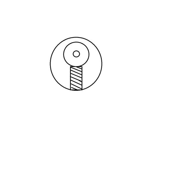

On the topic of cam walk. Maybe someone here can verify that my thoughts are correct.
I made a couple example pictures.. Now not to scale but I hope it helps to give an idea.
First off the aluminum bushing was completely trashed and the hole for the oil pump shaft was oblong and the shaft gear was riding more towards the front of the cam gear. Is it possible that with that gear forward that it pushed the cam back causing the rear most lifter to ride on the outer most part of the lobe. Here are some examples Of what im talking about.
Right is front of the engine
riding more towards the front of the cam gear would force it backwards.

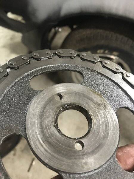

Here is a picture of the wear on the back of the cam sprocket.
I don't think so. Based on your logic, I'd expect more lobes to be damaged, not just that one.

The lifters always put a rearward thrust on the cam, thats how it's designed... the lifter bottom is slightly crowned & the lobes are slightly tapered taller in the rear and shorter in the front... So the valve spring pressure always pushing the lifter down also always puts rearward pressure on the cam... Thrust is taken by the back of the cam gear and the face of the block...
When people put roller cams in the rearward thrust is eliminated because roller lifters & lobes aren't tapered/crowned... That's why a roller cam requires a thrust button be added...
All that said no the gear didn't push the cam back causing a lifter to eat a lobe...

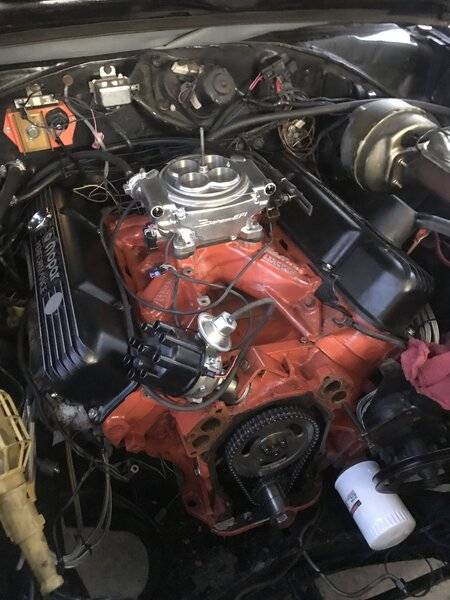

It’s alive made it through cam break-in now just working out some bugs here and there. I’m pretty sure I have to drop the pan so I can replace the rear main seal. I’m a dumbass and had the engine out 3 years ago and didn’t do it then. I’ll pay for it now lol

Next up will be getting the Sure Grip put together and installed. Then I have to clean up that wiring from when I replaced the heater core and rebuilt the box. I forgot to go back over to do it. THe car was 20 miles away. Easy to forget when you don't see it every day. Should be road ready soon. Lots of little stuff.
