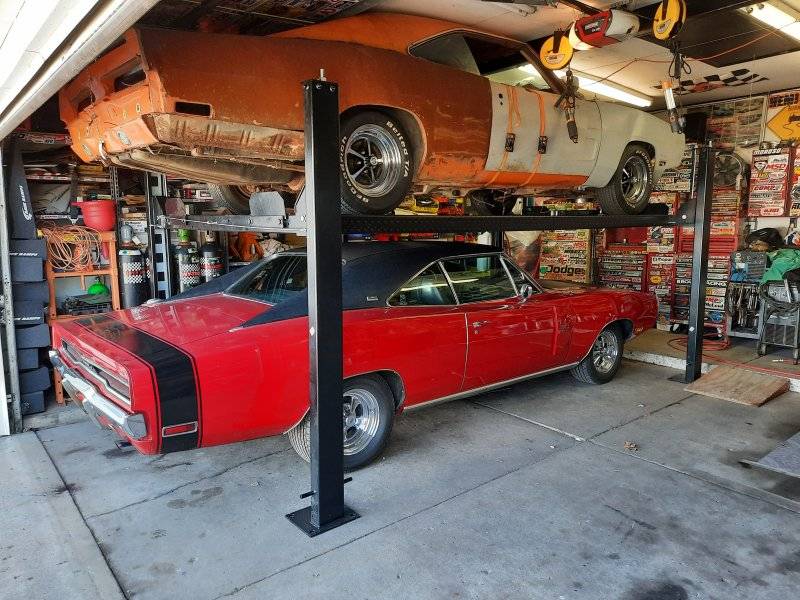

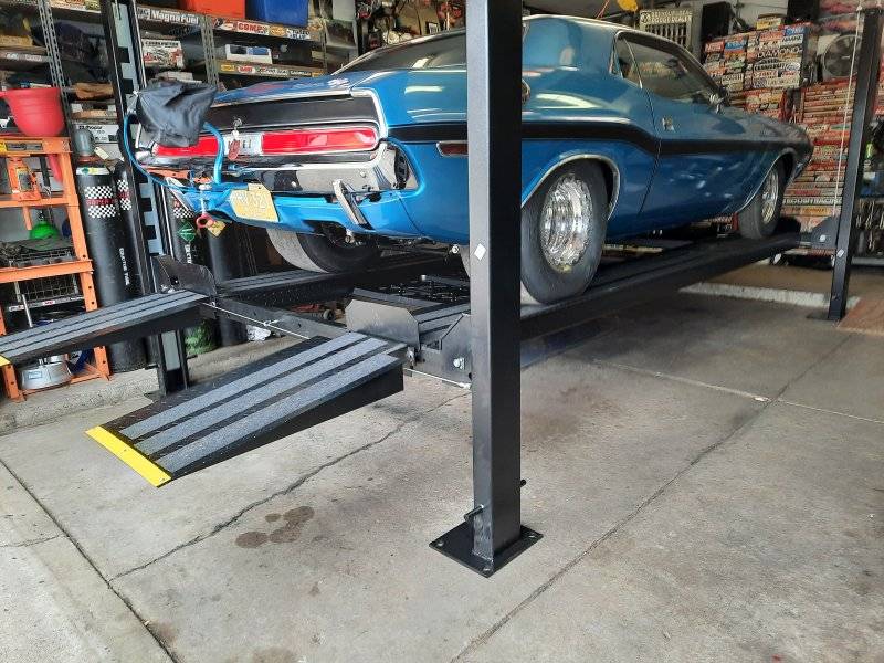

9 10 no issue Kent. I have 10' 3 and can park the Bee and Dart underneath with the Bird up top and the wing means the car roof is 9" from the ceiling.
I'm sitting in the shop so here's my Sat locked in measured at roof = 8' 9". Car sits 57" high vs Bee at 53".

I just went out and measured again and the best height reduction you are going to get by pulling the wheels is 6, maybe 7" if you set the car right on the drums. Lift as I showed above, simulating your ceiling height, has only 44" of clearance under it. So 44 + 6 would give you 50" max. Even if I put my Bee on top at only 53" vs the Sat's 57", while that 4" difference would now appear to give the ability of 54" on the bottom the lift locks are 6" apart. Now that said the lock plates, at least on mine, are adjustable a BIT for height to level each legs lock in spot. You could also cut 2" out of the lock holes at that height so it would lock in at a 4" raise and not 6 in that "top" position.
Ten four on that Wayne. Thanks once more for going out of your way to help a fella out. :thumbsup: Where there's a will there's a way. I also wondered about installing "custom locks" on the lift to achieve my height goals. Time will tell. Once I get the Charger up and running I'll be game for anything. Ceiling adjustments, new footings?? You just never know.
