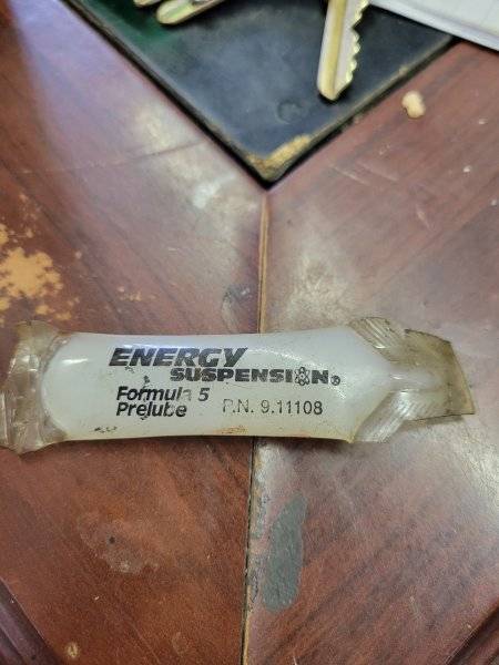

Thanks, used the little packet of silicone grease on the bushing and shaft that came in the kit to assemble. Greaseable pivot shafts have a zerk fitting, so you grease them for maintenance along with the rest of the front suspension. What I'm wondering is there a type of grease that can be used on all points of the front suspension so I don't have to use two different types of grease.
