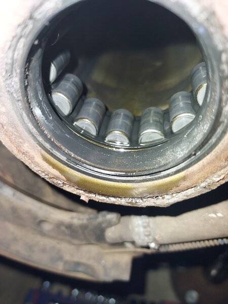

And for the last, how many years, has Dodge been using a roller bearing in their truck rear axles that don't even use a inner race. The rollers actually run right on the axle. :rolleyes:
The internal "C" clip in the differential takes up the side load. Just like the outer flange does when using the Green bearings.
Lots of cars went to the straight rollers with the axle being the inner race and did that pretty early on.....mid 70's or so I think.
The bearing assembly shown is a true "roller bearing" using cylindrical roller bearing elements, but it is NOT a true Tapered Roller Bearing, or a "Green" style ball bearing. This is a very common way of obtaining a roller bearing design. It is capable of high radial loads and zero axial loads, not even coefficient of linear expansion loads due to temperature change. A snap ring, either on the shaft or on the bearing housing is usually just for assembly purposes. If the rollers are required to run directly on the shaft, the shaft must be hardened, to at least Rockwell C 40-50, by heat treating, induction heating, or flame hardening. These techniques will replace the usual Inner Race of the bearing. Sometimes, this will yield a stronger shaft section modulus, due to the shaft diameter increase, by eliminating the bearing's inner race, to increase bending moment, without increasing the overall bearing sssembly dimensions. Just a few additional talking points......

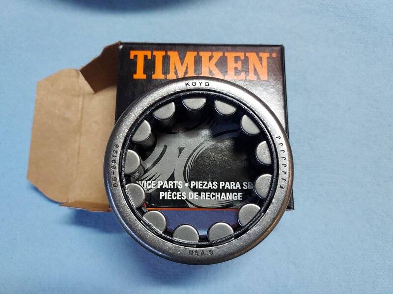

So, that's a Koyo bearing in a Timken box?
OR a KOYO BEARING resting on a Timken Bearing box. The bearing has a USA stamp, # DB 88128 part number, but Timken makes cylindrical roller bearings also....
Timken® Cylindrical Bearings
Minimize drag. Reduce heat. And perform better, for longer, with less maintenance and downtime. These are the true tests of any bearing. Our comprehensive line of single-, double- and multi-row Timken® cylindrical roller bearings helps extend equipment life and lower maintenance costs.
FYI....... www.timken.com/products/timken-engineered-bearings. Products, specs, dimensions etc. All you ever wanted to know about bearings.......can't get this kind of info for Green bearings.....wonder why?
