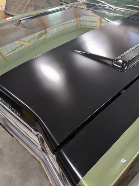

Is ths the right texture for the black on the GTX hood? I saw a roadrunner yesterday and that paint was really a rough surface .
It's a 69 if that makes a difference?

The green car is to smooth & to shiny... As 33 IMP posted organisol is textured and semi-flat
Organosol from day one,
I still have an unused pint of PPG DDL which is the PPG version of the original, which is also no longer, made to duplicate this. Had it on my road runner. It was perfect but hard to keep dust free and clean.
The blue car is right IMO. That original organisol was tricky to paint and the texture depended on how close you were spraying and and how thick you laid it on. It's one of those deals where you could probably pull 5 of them off the assembly line and they had 5 different finishes. Also note the original formula had light metallic in it as shown on the blue Runner.

Agreed. The blue car looks right.

Thanks for the replies!! Yeah, so that DDL 9355 someone gave me is not correct? I had a body shop that I like do the paint work and I thought he did the DDL 9355 because that is what someone gave me.. So what is the thought here, is this the driver solution now? Or should I try to get it closer?

Your body shop didn't use your DDL-9355, they either didn't trust an old can of lacquer or the had another project in mind for it & didn't think you would know the difference.... As far as what to do? The hood is gonna be easier to take care of with the current finish & lots of people are happy with that sort of finish... Personally I think Mopar's organisol is an important part of making these cars look right so U would have to respray it....

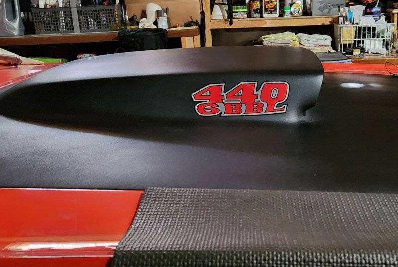

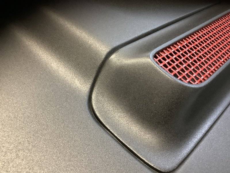

Original un-repainted A12 Hood
Typically they'll describe its texture as "Enough to cause a shop towel or bath cloth to Drag or catch on the surface but NOT enough to pull fibers from said cloth", I have seen some of the V21 type painted hoods/stripes on UNRESTORED cars that are nearly just a flat black with nearly NO Texture. That may be a different paint type than the A12 hood type

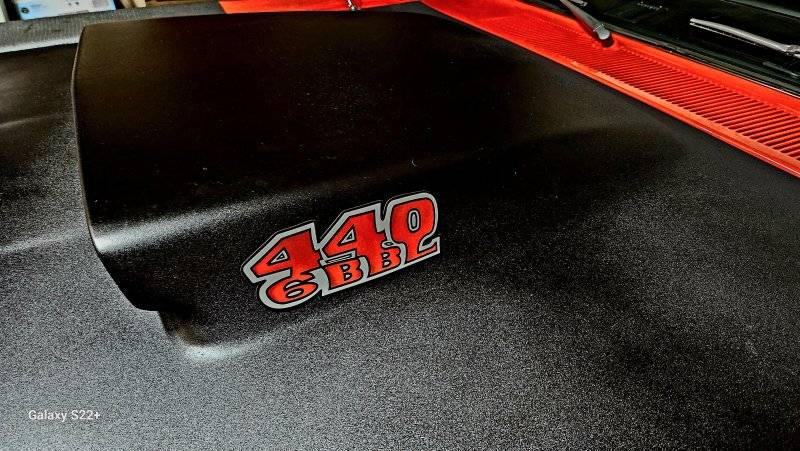

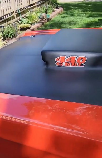

I used SPI black epoxy for mine and it looks just like your picture, low gloss but no texture. I have been reading about different spray techniques using U-POL Raptor, thin it, spray it with HVLP and a big tip, hold gun farther away for more texture, etc.
I plan to play around with some samples when I have some time this winter.
sprayed organisol on my Roadrunner 20yrs ago when it was a a available but for the Cuda I recently finished I had to use SC804, a BASF product, looks good and has a slight texture
