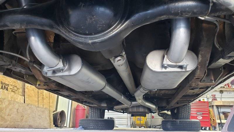

Had small issue with the cross over piece not long enough for my car. Is that a solid cross over or a slipover, mine was 2 piece. Only had to buy short pipe expanded on one end. Note the trans cross member where the cutouts for exhaust pipe, my headers are wide. Edit it's 3", think cross is 2.5".

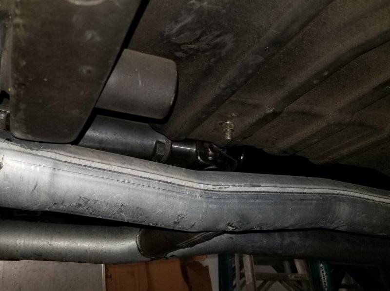

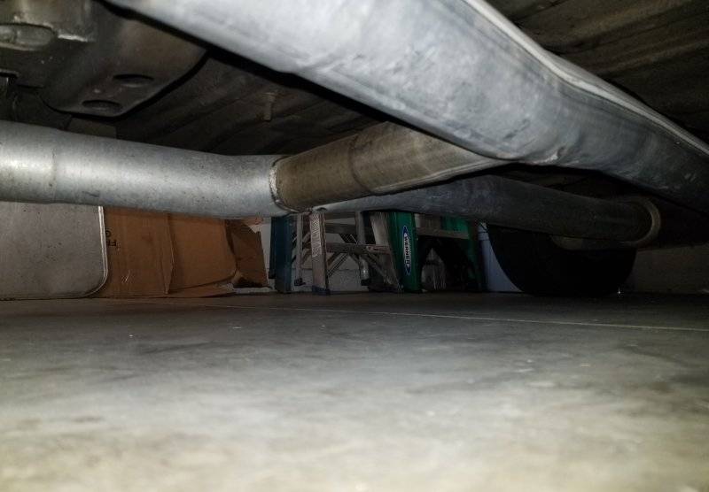

You have the same car as me 68 satellite anyways I can get a quick picture of what you have don’t have to be great. I would be very helpful for me. Thanks Tom.
Beanhead
Best I could do reaching under there Tom, hope it helps you--

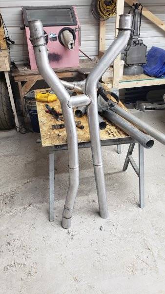

Welding your own in is way cheaper but could be a hassle if you don't have pipe fittings that come apart easy. TTI stuff works and fits. I doubt there would be an issue with headers.

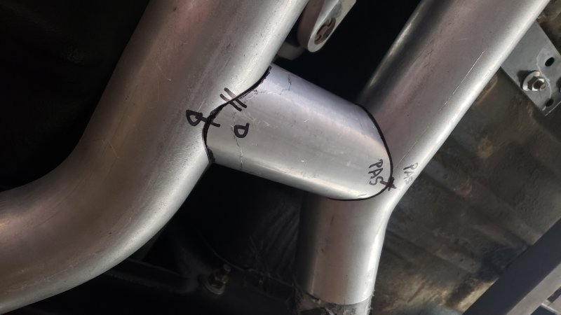

Here is my home made 3" H pipe on my 69 GTX. No issues with the transmission.
