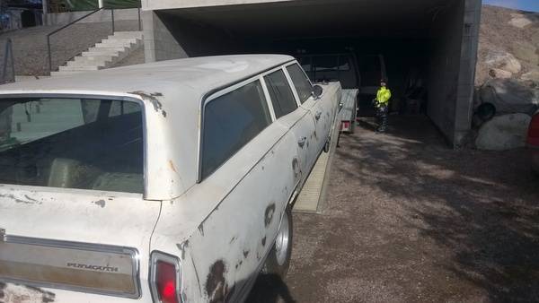

My son did the winching to get it on my ramp truck.

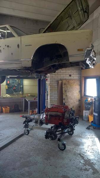

I neede to move the body to another location where I had the lift.
On two post lift, the next move is down.

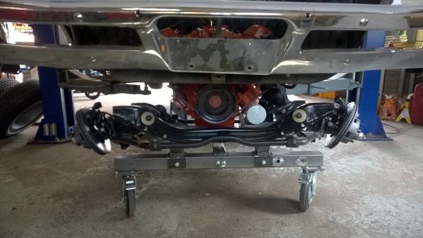

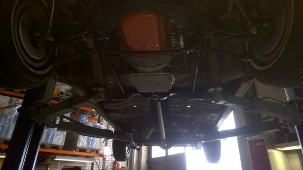

It was unbelievably easy to get all this back into body this way.

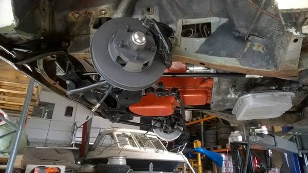

It took only 45mins to get it back on wheels this way and only help was my 7 year old son.
.960" torsion bars were installed and the previously mentioned drive shaft with 1350 joints.
