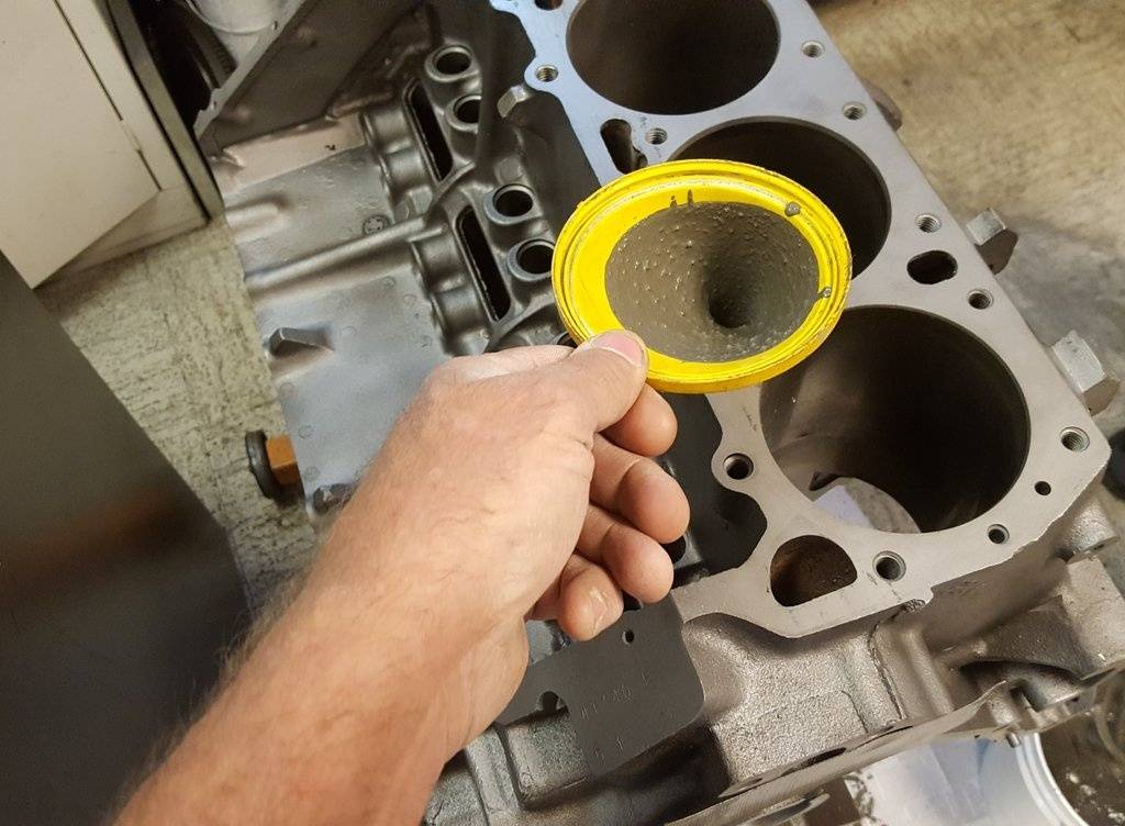

Hello budnicks ! thank you for the info, the more I research the better I feel about filling the block I'm only gonna fill it half way and i should be ok with the drive to the occasional corner car show, not 100% sure on what fuel ill be running maybe 112 q16 mix ?
We'll see what happens hopefully in a week or so.
Stock block, stock stroke 440 with bcr aluminum caps.
Thinking maybe around 750 hp.

I have very limited experience (only 1 weekend), but my 1/2 filled block seems to get up to 170* and stay there. Stock 440 block, Indy aluminum heads.

My combo is a stock 440 block 1/2 filled, Indy EZ-1 head, 12.4 CR. I drive it around the pits. The return road at BIR is EXTREMELY long , no heat up issues. The temp stays really fine, at least as good as my 500" 10.5 CR motor. Aluminum radiator (not sure what brand, works great), stock Chrysler clutch fan.
My 2 Cents. U definitely need the alum caps or billet caps and a girdle to reduce cap walk. Hard blocking a block was never intended for the street. The purpose of hard blocking is to stabilize the cylinder bores. Not to stabilize the bottom end. Although it is an added benefit. U may get away with filling only the bottom 2 inches without over heating issues. Just because it worked for someone else doesn't mean it will work for you. U won't really know until you try it. My race block is half filled, studs, alum caped and girdled, external single oil pickup. This combo is good for around 750hp with longevity. More HP, less longevity. If your looking for big cubes on the street you need a full water jacket. Which spells aftermarket block. Or just more rebuilds to keep it happy.
