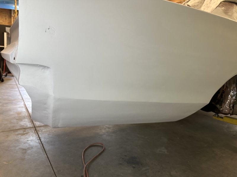

So, in this photo, you are matching the door and fender?
yes, after welding a small patch in both..... I also sliced the fender vertically (and welded) to open up the gap a little

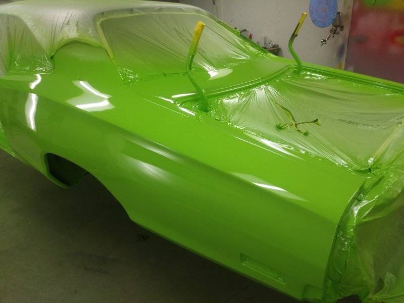

1/4 skins on a pretty rough car......

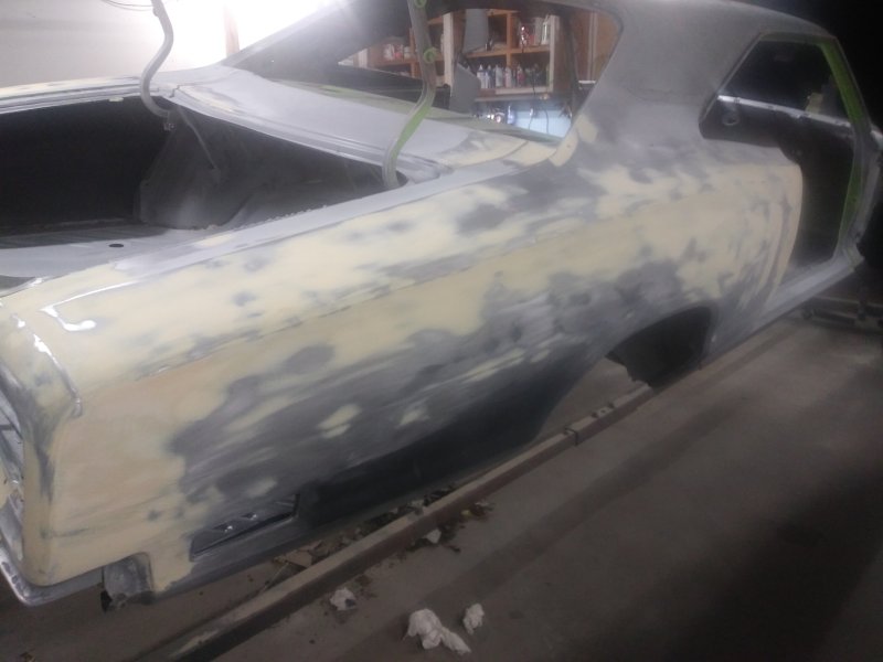

Okay, time for a status update and thanks to all those who provided advice (with a special shout out to eldubb440).

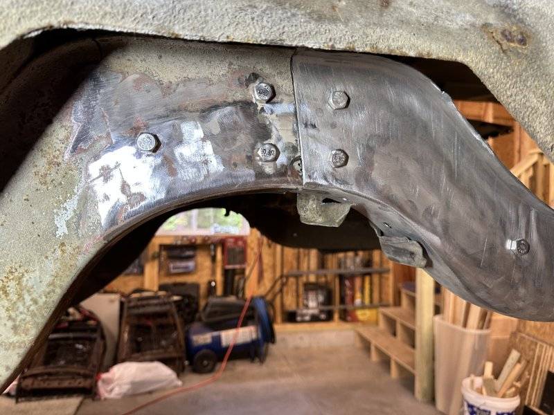

1) I bought a POS on purpose (68 Coronet 500 - my high school car) so I could learn how to weld, fabricate, do body work, and paint. I started with the rear:
2) I replaced the rear driver's side frame rail because it was rotted:

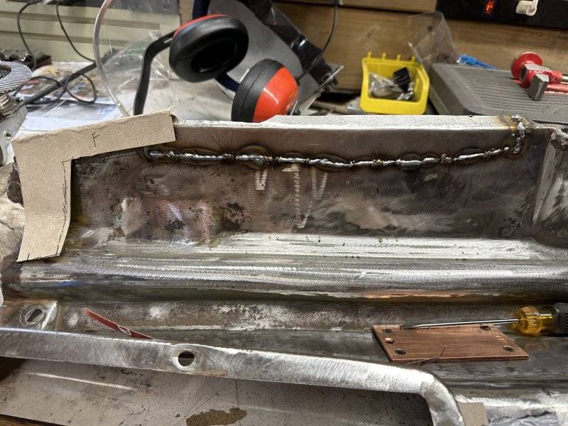

3) I fabricated a sleeve and bolted and then welded it for strength (I wasn't confident in my welding yet, and yes, I ground down the bolt heads so they're barely noticeable):

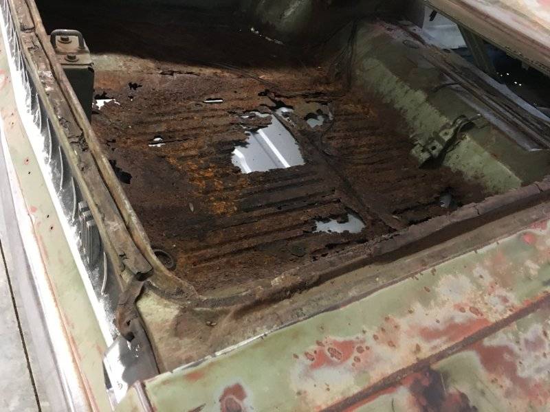

4) Meanwhile, I removed the tail and the rotted trunk:

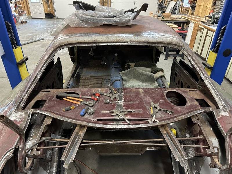

5) and since I had access and it needed it, I cut and replace the whole rear window and deck with a donor from Arizona:

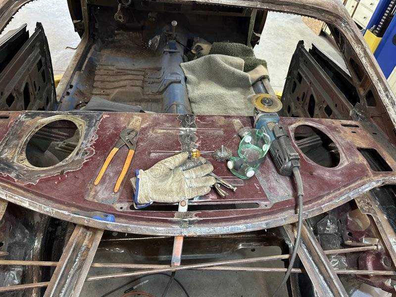

6) Since I was now more confident with welding (and grinding), I replaced the driver's side speaker hole on the donor with the original 6x9":

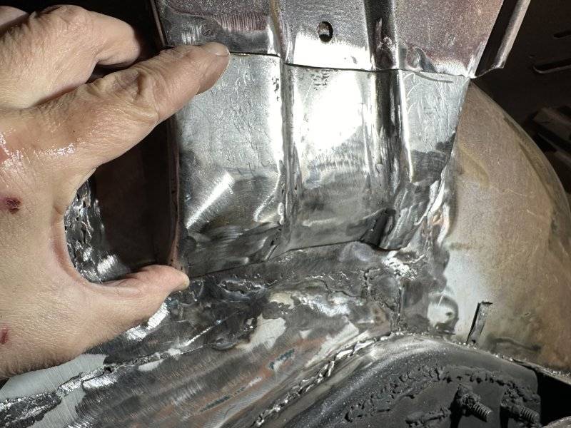

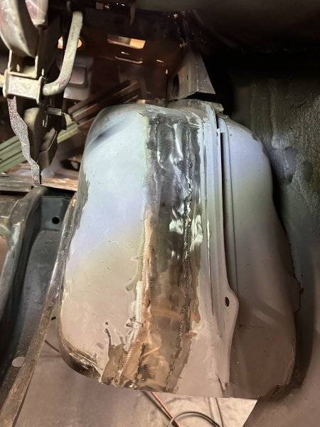

7) And since we're here, we might as well mini-tub the wheel wells:
8) Which meant that I had to fabricate some new trunk hinge brackets:

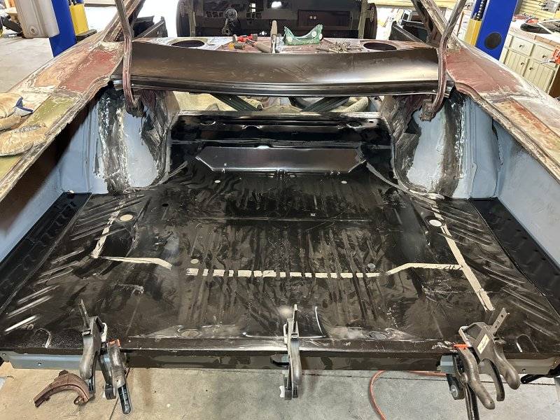

9) Because of the mini-tubbing, I had to tweak the trunk floor (from AMD). And you can see my new cross panel and dutchman panel as well:
10) I drilled and spot welded the trunk floor and drops to the frame/wheel wells/quarter panels using the trunk lid as my continuous guide:
11) Meanwhile, the tail panel needed a LOT of fabrication (I think I cut and welded in 12 new pieces):
12) Once the tail panel was fixed up, I welded it onto the car (again using the trunk lid to guide me):
13) I had no idea what the bottom of the end pieces were supposed to look like so I fabricated something that looked like it would work:

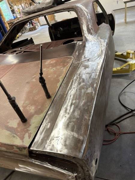

14) Using the trunk lid as my guide, I did some final adjustments (I had to raise the middle of the dutchman panel 1/4" and I had to build up the end of the quarters with about 1/8" of filler to get the required flare.):

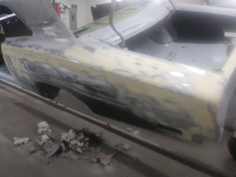

15) I did a lot of pounding a filling to smoother out the quarterpanels:
16) And lots of sanding and filling and sanding and filling (I'm now pretty good at this :)); I put two coats of epoxy primer on everything (just to keep things stable while I work on the rest of the car):
Next I finish the mini-tubs and the package tray. Then it's onto the rear seat pans and continue moving forward. Then I'll come back and take care of all the small blemishes and dents (which really show up in these pictures) in preparation for painting. Check for my update in 2027 :)

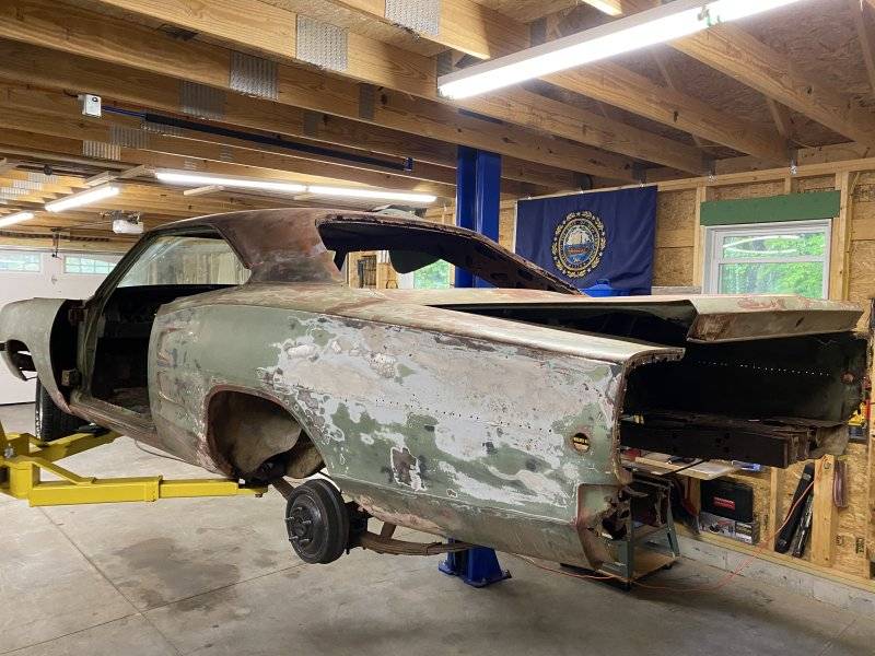

Great work on the car but what impressed me is the way that you utilized the limited space of your ceiling to use the two post lift.
