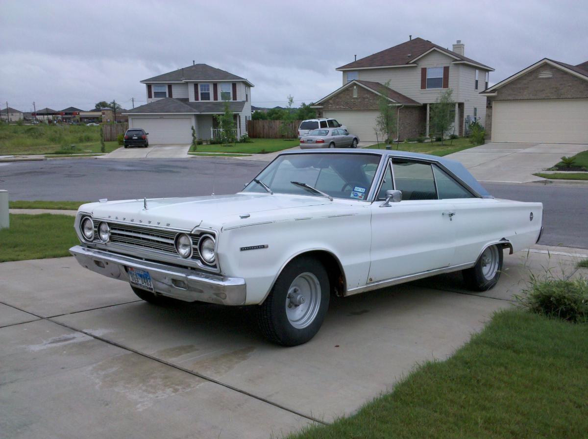

OK, so here's the deal. I have a 67 Belvedere II with a 318 that I believe came out of a 69 Dart. It's my first project car. It's been really hard to start and I ended up draining the battery trying to get it going. I recharged the battery (probably a year old at the most) and tried again but when I turned the ignition I would just hear a click.
I replaced the starter since the one on it looked pretty old. After replacing the starter she started like a champ. I've been driving her for a few days and today she started giving me a little trouble starting again. Once started she ran a little rough and died a couple of times at stop lights.
When I got the car I was told that the timing probably needed to be adjusted. I'm under the impression that the battery and starter are fine since they're both pretty new. My next guess is that the spark plugs need to be replaced. I'm very new to the mechanic world so any incite would be greatly appreciated.
