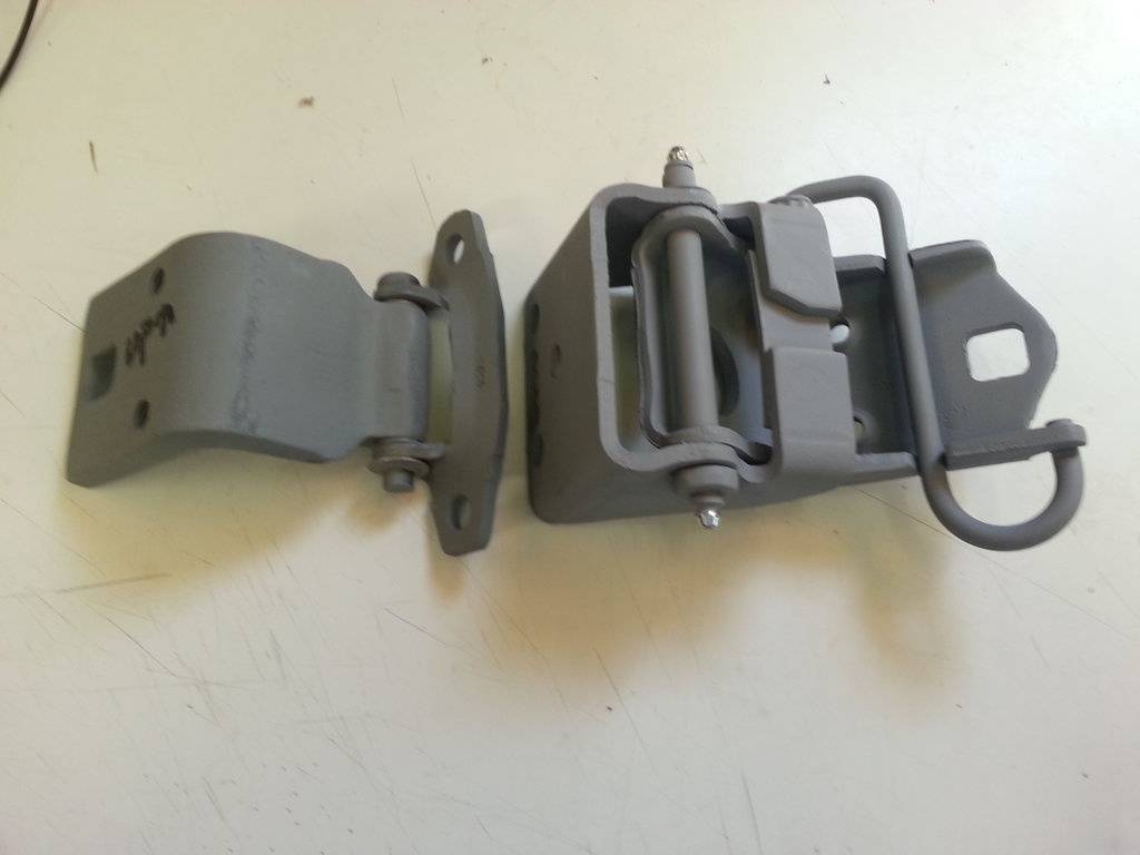

I spoke with superbird Bob. Nice guy and loves mopars. Bought a driver's side set from him $100, $30 core, and $15 shipping. Should arrive this week. Hopefully will go easy with the swap.
Arrived late afternoon; Superbird Bob ACME rebuilt drivers hinges.

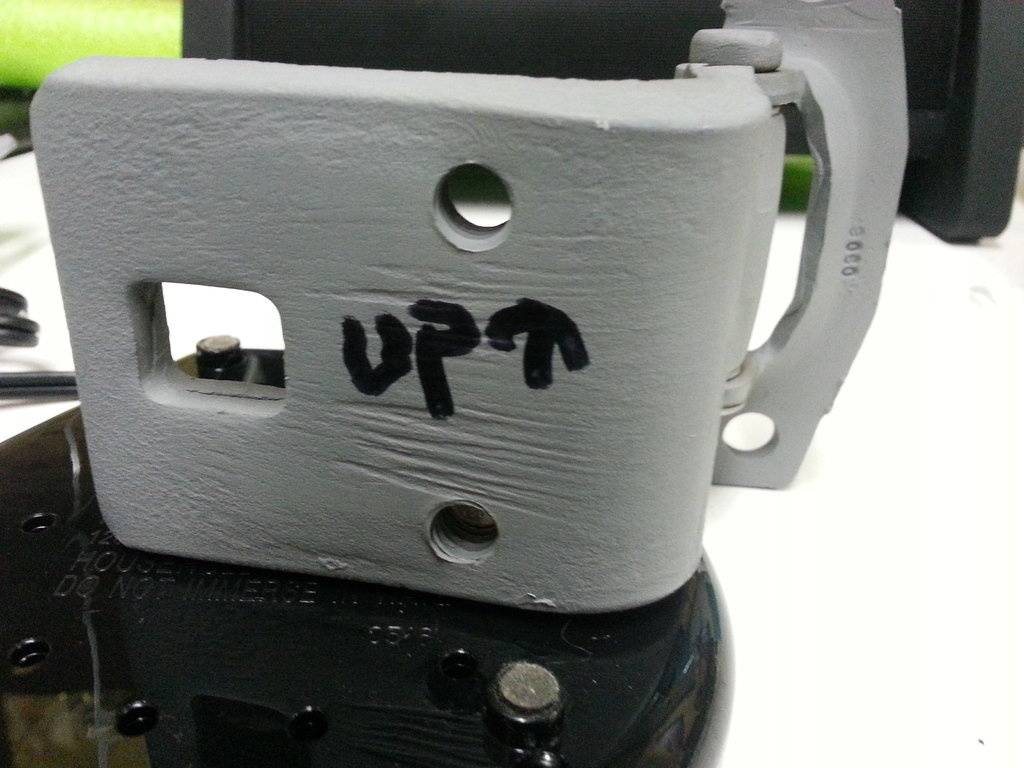

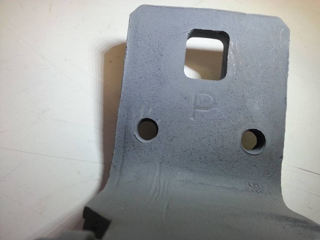

Just noticed my upper hinge is marked with a "P"; are they interchangeable from side to side?
Superbird Bob emailed and said this is the driver's top hinge and follow the orientation marked. What am I missing? This cannot fit on the driver's door in this orientation.
Superbird Bob just called me. Really nice guy and a true blue Mopar fan. Anyhow, his nephew packed the box and did send the wrong hinge. Replacements shipping today. Still recommend this guy for your hinges, but I'll update when the swap is complete.

Just finished rattle can rustoleum painting of the hinges. Duplicolor was too dark and rustoleum is too light. Oh well, these are only visible when the door is open.

I will say that Superbird Bob's rebuilt hinges are excellent quality. My rattle can rustoleum paint job did not match that well, but once the hinges are in there it really is barely noticeable. Yes, it won't pass concourse judging, but you really have to study the hinges to see the color mismatch.
