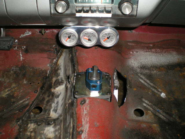

yes I'm in the midst of repalcing my 4 speed with there tko 600 5 speed in my 62 plymouth. I found they dont tell you every thing...like you will need there shifter as the tko is a top loader and sits up under the dash on a 62 B body and you will have to do tunnel ajustments with a BFH and cut ears off the tranny which arnt used. I checked my housing run out and it was anywere from .001-.003 which is within there tolerances. I found the tranny mount is off centre by half inch and when i called support they told me my engine is in on a skew????? Well I have a new 440 to go in it so we'll see whats up. I think its the trans crossmember as its welded off set.if you have a automatic im not sure if the pilot hole is different but may be.kick down link will be gone if your going to the 5 speed. It is a big job and will take time to finess it in there. but I cant wait to give it a go!!!!

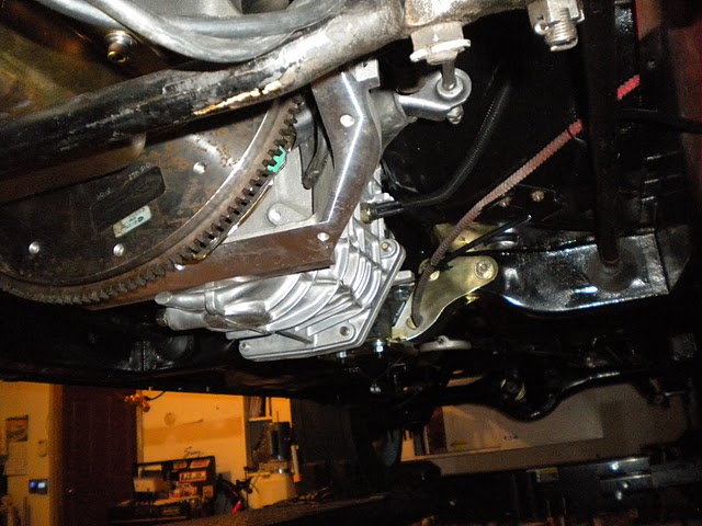

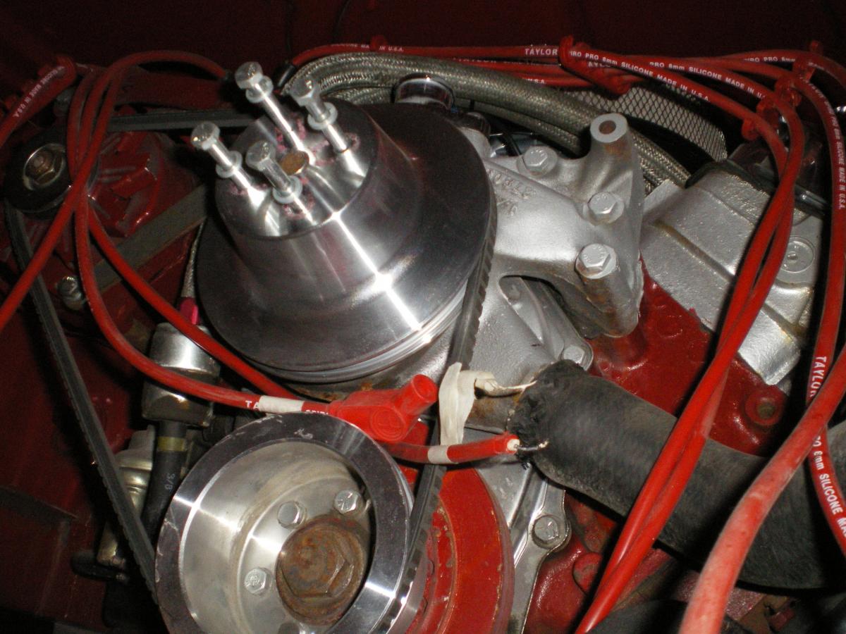

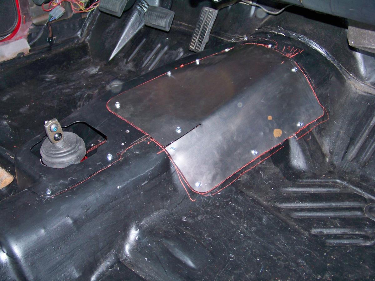

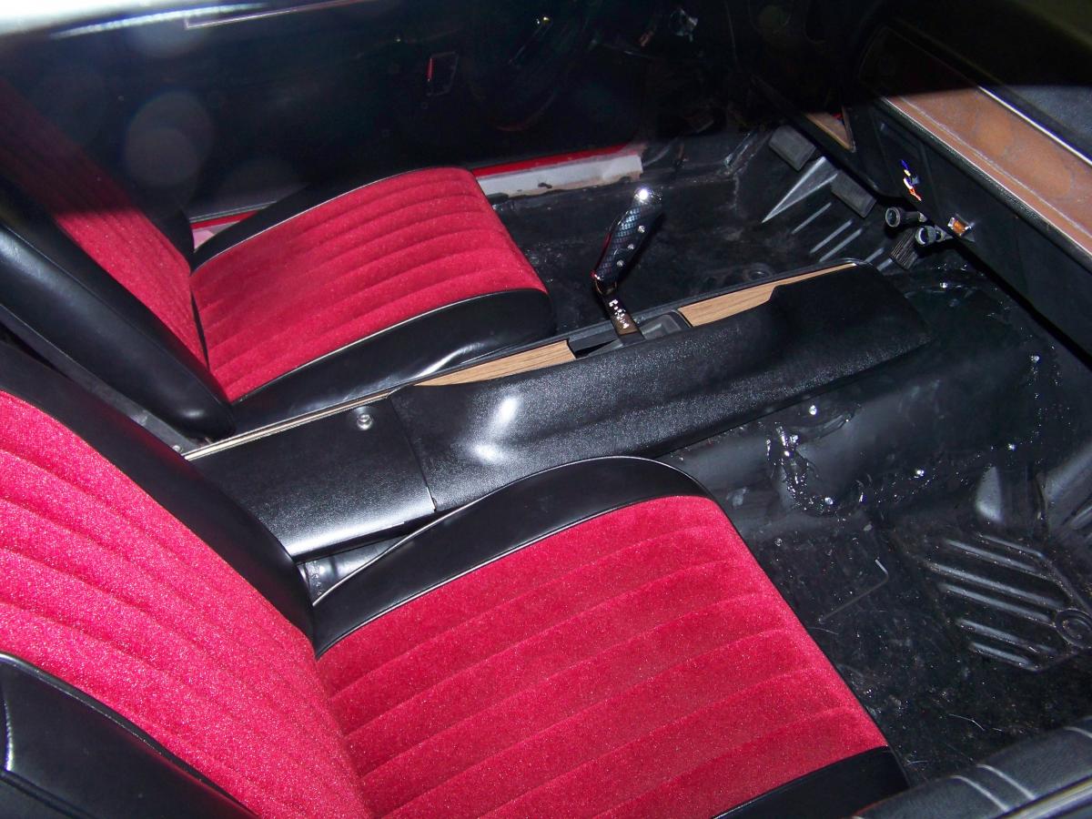

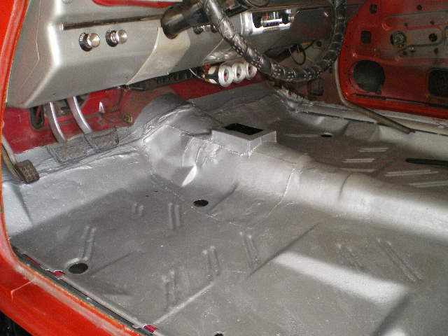

Keisler in a 73 RR

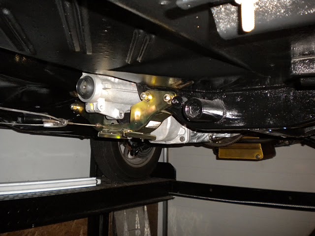

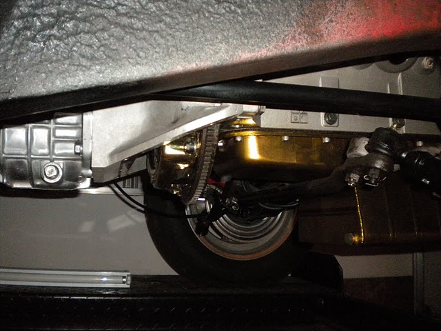

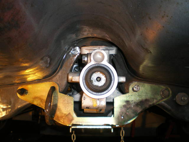

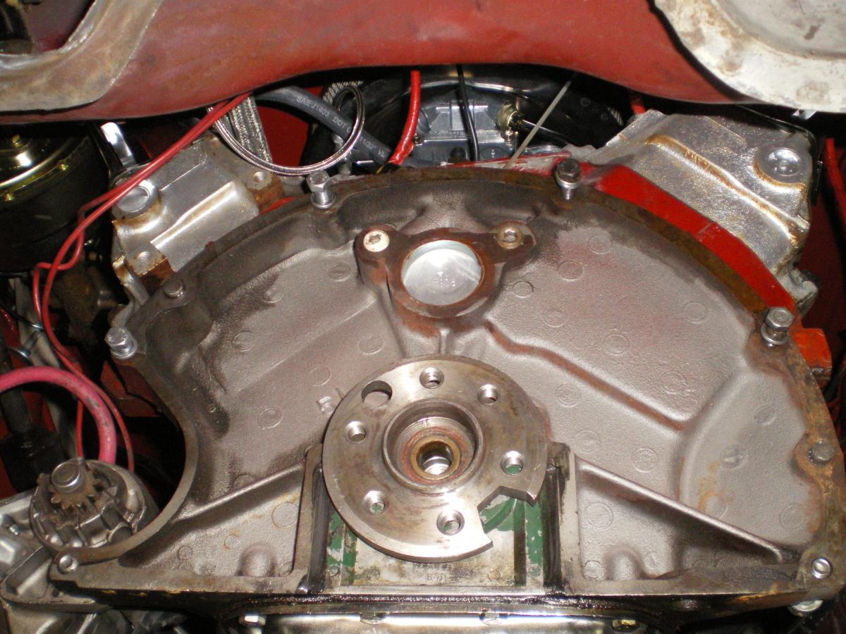

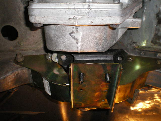

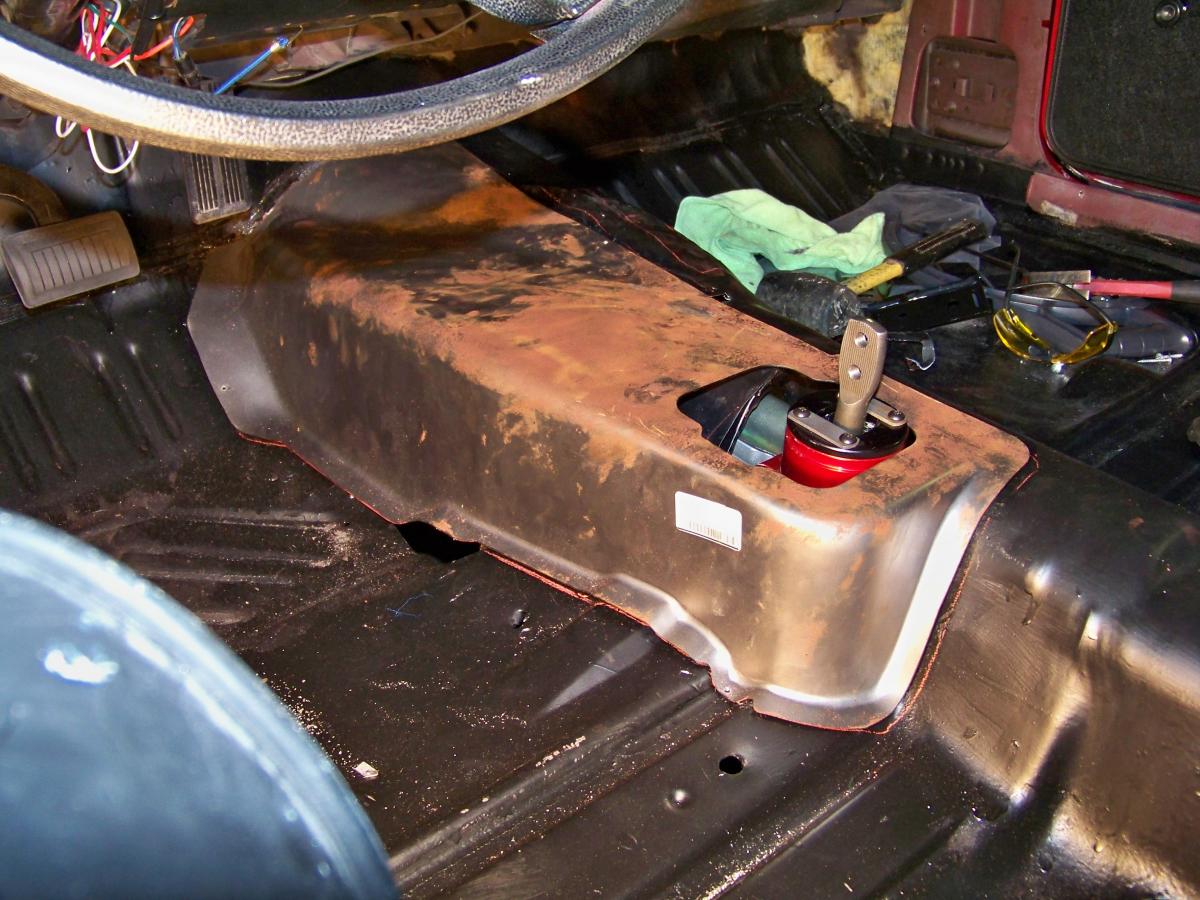

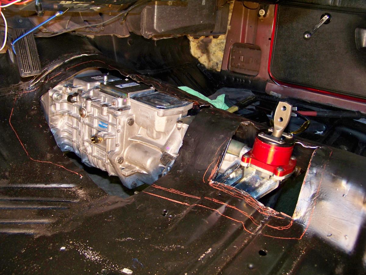

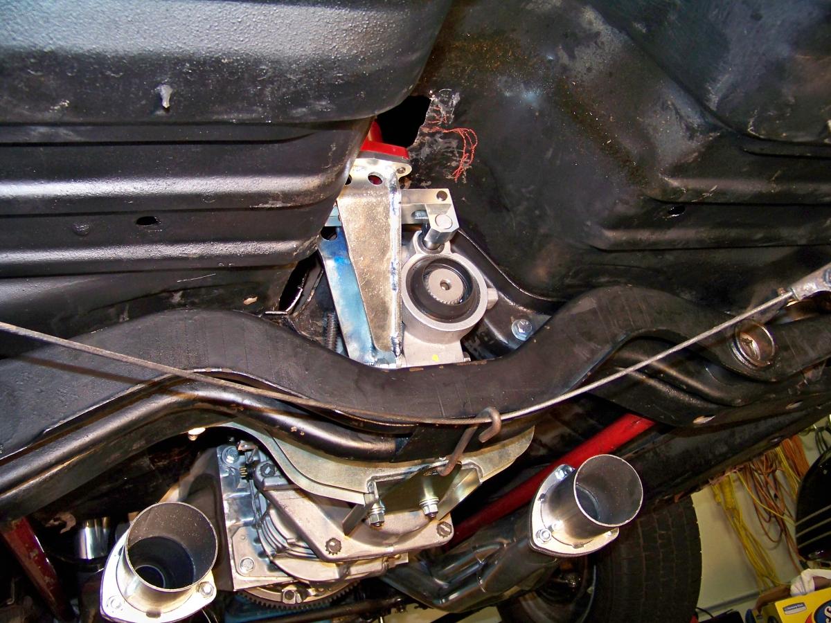

I install a Keisler 5 spd in a 73 RR. The steps were straight forward and not a bad installation time - first time for me.
I thought that you may like to see some pictures as the work progressed.
My advise would be to buy the whole kit from keisler its much easier that way. The crankshaft gets a roller bushing that fits in nicely. They have tech support that guided me through the steps when i needed it.
Hope this helps. Email me at ralphcali@yahoo.com if you want more photos of the process could not load all of them up here.

Keisler 5 spd
Here's a few more photos
Ralph

great pics!!!

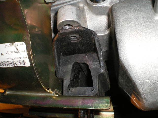

On my 73 RR I did not lower the engine other than the trany mount spacers they provide in the kit - it isnt much.
Pull the plugs and get a flywheel tool that rotates the engine ( few bucks)
Get the keisler instructions on the bell housing alignment or the internet. I did not use the offset dowel pins mine was ok. Keisler said that a check was a smooth 3 to 4 shift
Ralph
the back of the engine is lower once you take out the tranny crossmember and the oil pan will sit on the steering rod.Turn the crank from the front with a socket and long bar easy!!!

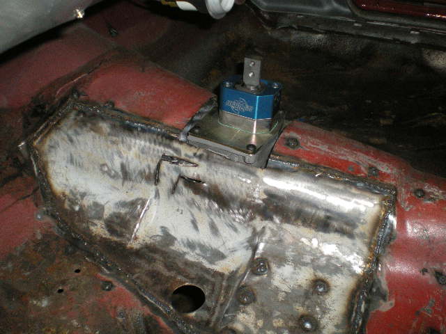

I changed the hump since i had a bench seat hump and need the console hump so I borrowed a mig welder and it was first time - but i did it. You know as i understand it all cars started on the assembly line as automatics and then they cut out the hump for the 4spd tunnel - comes out easy and you can buy the console hump just about anywhere.

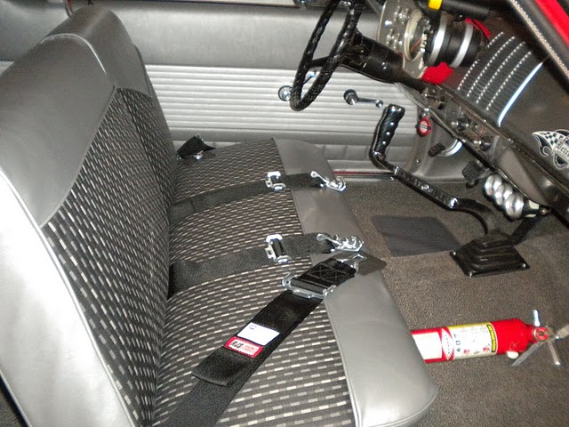

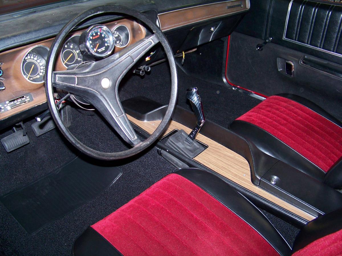

well I finally got it in and i'm happy with the fit.It was a bit tight but managed to get it done. now i'll have to get used to the short shifts!!!
