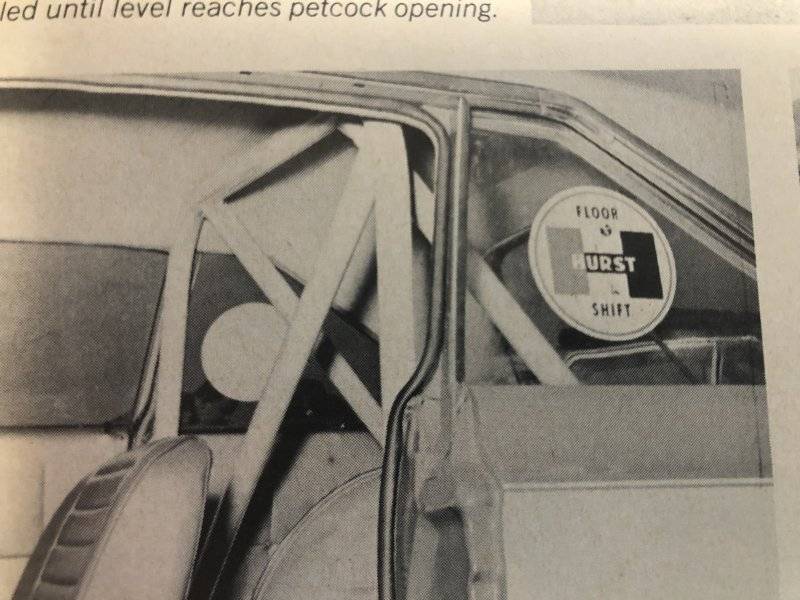

Yes, look back at the 65 altered wheelbase factory cars, all hard tops and the were bending like crazy. Chrysler tried to get the racers NOT to do wheelstands. Eventually they became bent beyond repair
The awb cars had the same b pillars as the sedan, they were severely weakened by the acid dipping and only a few teams knew to tie the frame from the start, ultimately all were reinforced in some way, the launch is what was bending the bodies, front end damage was the result of the “wheelies”

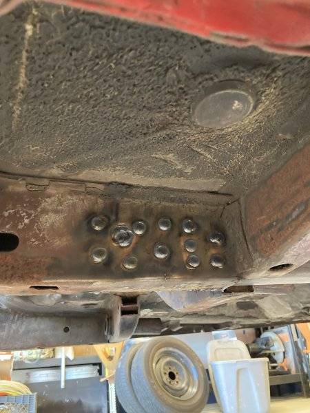

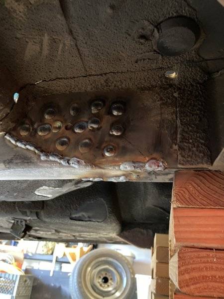

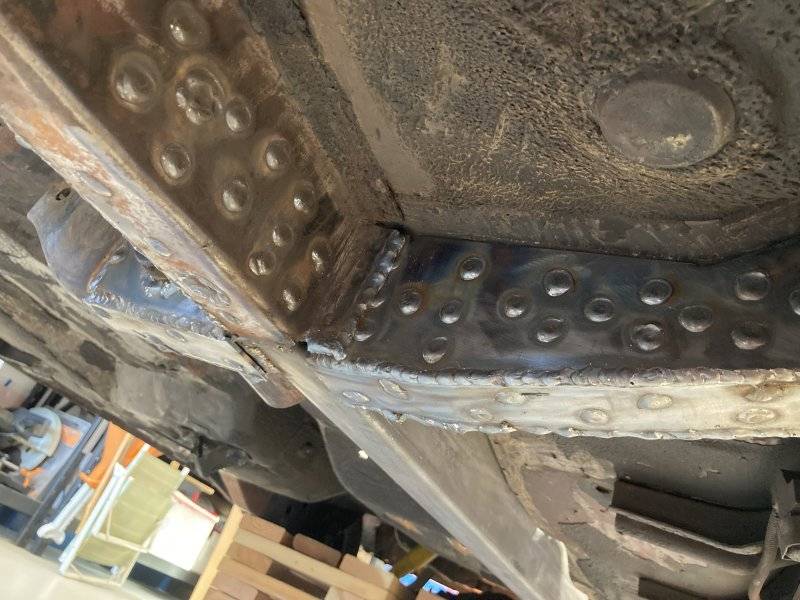

I cut the spot welds on the floor where the rails attached for 8-10" back from the edge of the rails. Then I slit the rails for about the same distance along the vertical portion, pulled the vertical walls into contact with the new sfc"s using c-clamps and vise grip welding pliers[ after drilling several 5/16" holes in the vertical walls]. From there bounced around welding the holes after moving the clamps around to get the most contact between old and new. Lots of weld grinding ensued afterwards.
All altered wheelbase cars from the factory where hardtops, races took the normal 65 sedans and made them altered wheelbase cars.

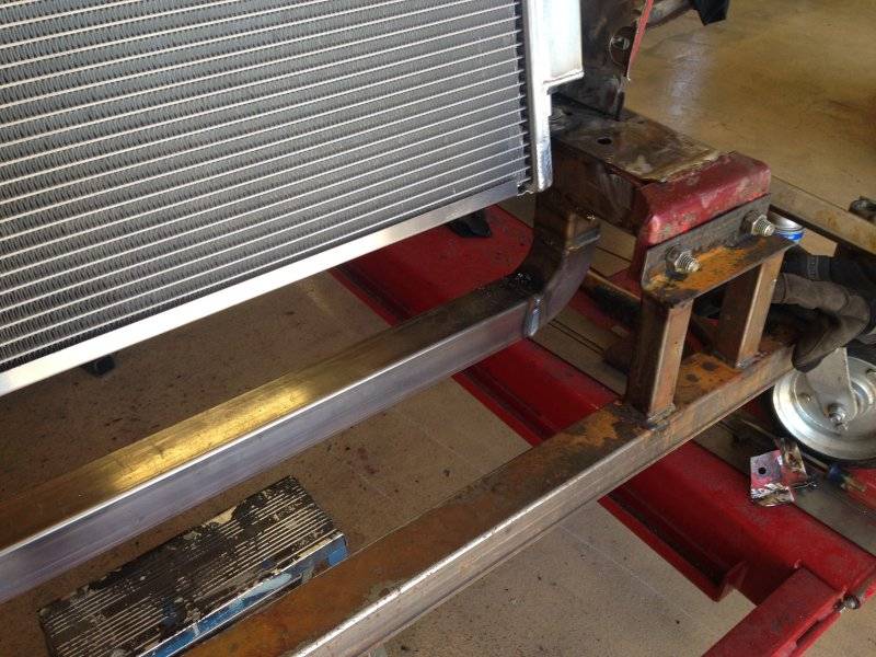

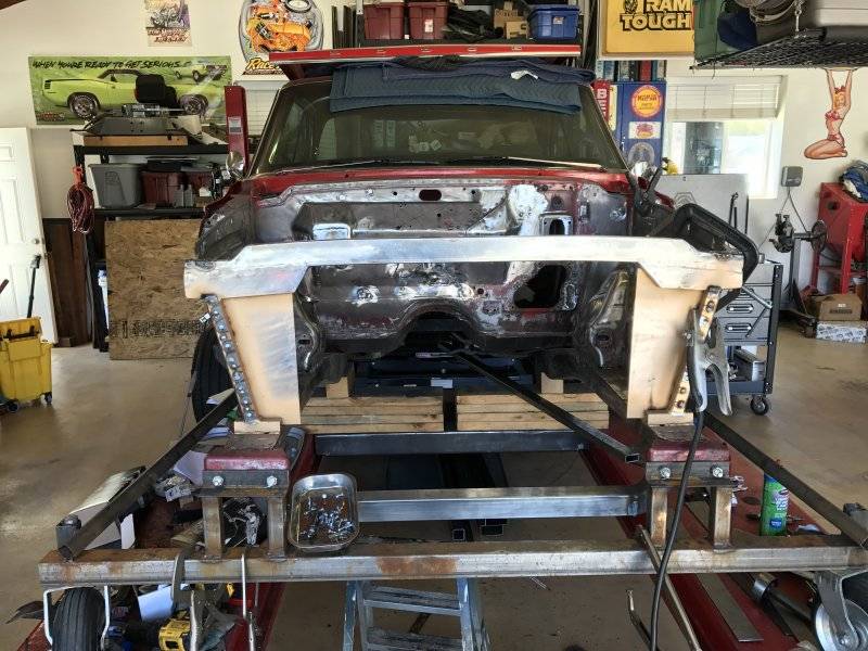

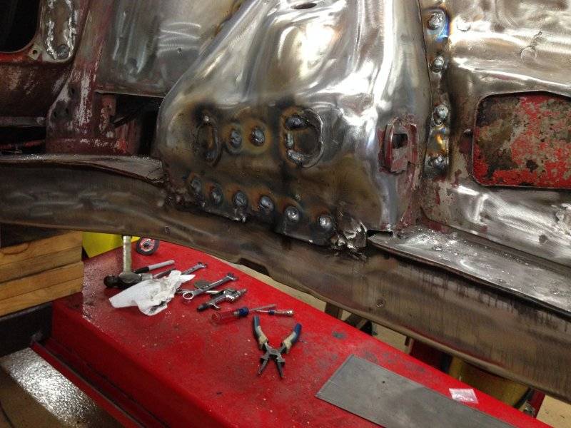

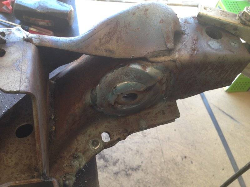

Adding spot welds in is easy. Along with doing my k-frame[ added 120+ welds], I added welds to the shock towers, where the upper arm attaches on the frames, along the frame flanges in the bay, made up a new lower tie bar, made a new core support. Just takes some time, but it will be worth it.
