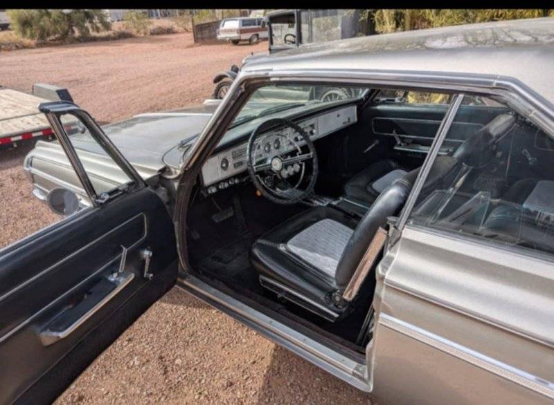

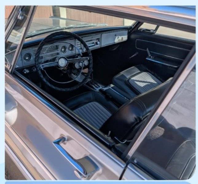

Has anyone moved their bucket seats back? 64 Polara
toolmanmike
Henchman #2
Staff member
11:38 PM
Aug 11, 2010
16,394
35,745
Iowa
I need to figure something out. I am just shy of 6' tall but my seat needs to go back further. It is as far back as it will go adjustment wise. I am setting pretty close to the steering wheel. Both the wheel and the seats are factory issued as far as I can tell.
I haven't looked underneath to see how they are built or attached but I was curious if anyone else out there in Moparland has had the same issue.
EDIT: I just looked at the photos and it looks like there should be plenty of room. I may need to go on A diet. I am pretty thick around the middle. :BangHead: :lol:

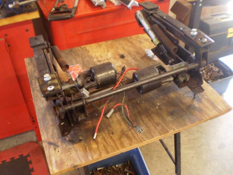

I bought universal seat mount extenders from Summit. They moved my drivers seat back 2". I also got rid of the original large oval steering wheel, and replaced it with a smaller 14" one (same size as steering wheel in my Jeep G.C.) that I bought from Classic Industries. I am 6'2". I thought about a tilt column, but it was too expensive. I also picked up a super rare 1964 Dodge power seat track for drivers bucket seat from a member on here. It might give more range of adjustment, too. I regard this as one of my greatest parts score! Last picture shows seat extenders installed on power frame.

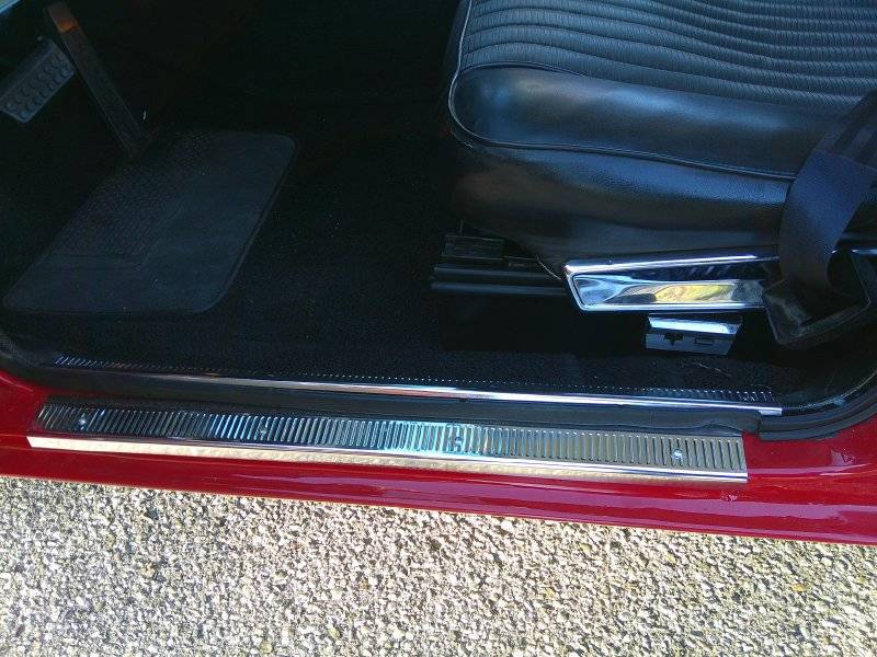

@toolmanmike not the best pic but if you zoom in on the hole at the bottom, you can see the 3 positions at which the seat can be mounted. This is my 64 Polara bench seat when it was off for new covers. Not a lot of adjustment but some. You've gotten good advice here on repositioning, but I'd start with this.
Thanks. Great photo. They look like the bases on my 66 Dart buckets. Really pretty handy for getting the seat just right for the driver. I really am spoiled with the power seats in our late model vehicles. 6 way, adjustable back, lumbar support. All a plus for comfort.
That power seat base looks like a winner. Were the track extensions anything like these? I just started poking around to see which ones may work the best.
That's them. I think I only bought one set of 4 to do just the driver's side. Even one bench seat would only need 4. If you notice on the lower frame part of your seat, there is a set of three holes the studs can be mounted in. The factory mounts the studs in the centre hole. You can gain an inch by knocking these out and moving them to the forward hole. They are kind of hard to knock out, because the factory swedged them in. A little grinding in there with a Dremel grinder might make things easier. Then you can JB Weld them into forward holes.

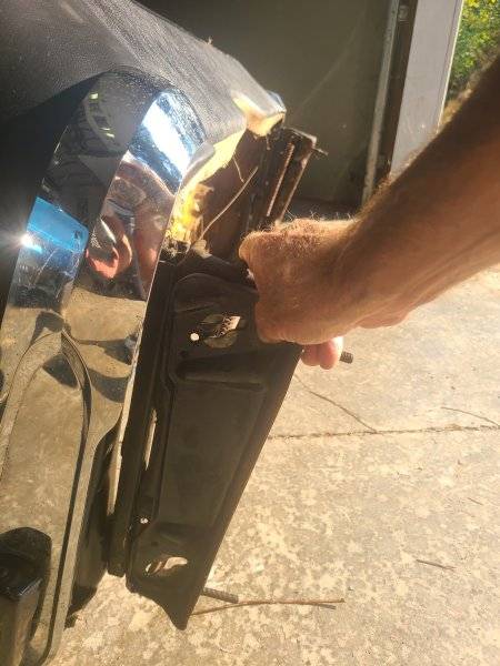

If your seat brackets are the same as a 66, there are adjustable locations where the lower bracket bolts to the brackets on the seat frame. You can see the two bolts that hold the two brackets together.
