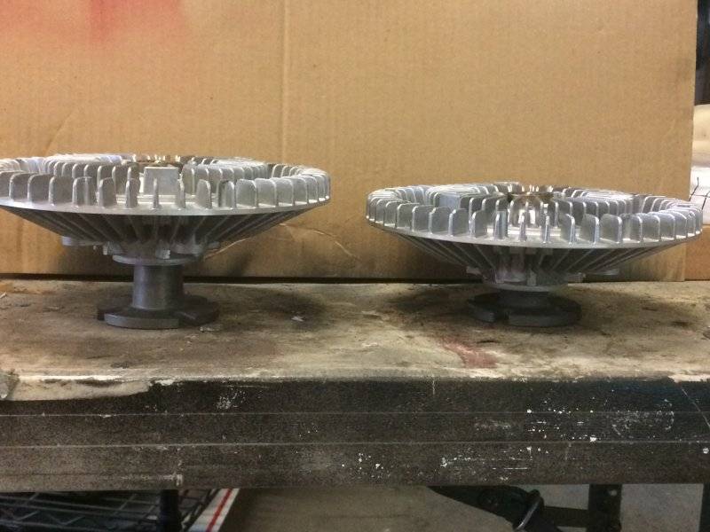

Good Morning. I Was wondering if I can get some info on fitment for a new clutch fan for my 64 sportfury.The one on my car spins freely.Would the haydon 4927 work the shaft is shorter than most thanks nick
First - does it tighten up after the engine is run and hot? They should turn freely (somewhat) on a cold engine. I read that the shorter depth were typically used on AC cars and the longer depth on non-AC cars (?). Sounds sort of reasonable. Typically you want the fan positioned about half in and half out of the shroud.

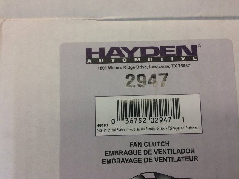

You have the number wrong.
The 2947 is the one on the right.
The down fall with the early Tony’s parts fan clutch is one, it does look Chinese(not 100% sure, packaging says for it is imo) two the early ones had additional mounting holes for the fan versus the four that are actually needed . If I’m paint for correct I want correct.. not 4 additional mounting holes and yes I have one but haven’t used it. The last repop one I bought from him only has 4 holes... new vendor?
I have the Hayden #2947 on all three of my cars. My '72 Dart 318 has the stock oem radiator. It's worth giving it a try. Some aftermarket radiators do have clearance issues.
I don’t know the thicknesses of the stock radiators. I do know that the thickness does vary with aftermarket units. The 2947 is your last option if clearance is limited. After that, you’re looking at electric fans.

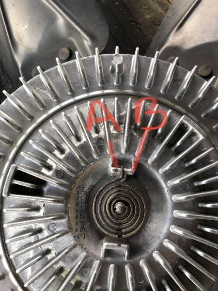

I wish the coils on these were adjustable. They just come on too late for my liking so I recut the coil anchor leg so that it starts locking up about 10* - 15* sooner. Not sure why I did not take a finished picture but cut a new notch at “A” and move the leg back.
