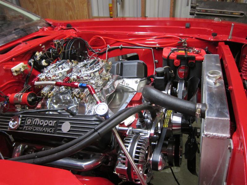

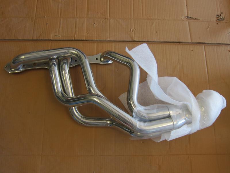

I bolted on a set of Headman Elite Hedders in my 73 Roadrunner with 440.
They fit real nice and had some room to spare.

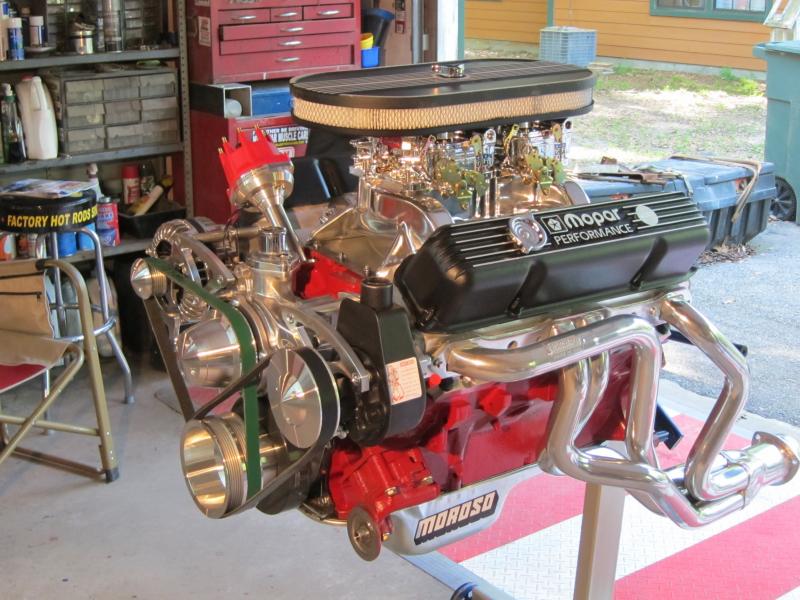

new TTI lungs lay on floor...
sonny is happy with TTI

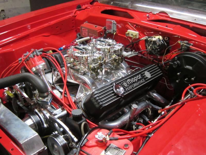

Here is the rest of the Car Pat.
