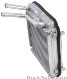

The Rock.
FOUR SEASONS 90500 Instant 10% Off Manufacturer Rebate!
Sale!
Info
One of our most popular parts
Aluminum Design; w/o A/C
Part image
$39.79
Add to Cart
SPECTRA PREMIUM 94500 Info
w/o Air Conditioning
Part image
$52.79
