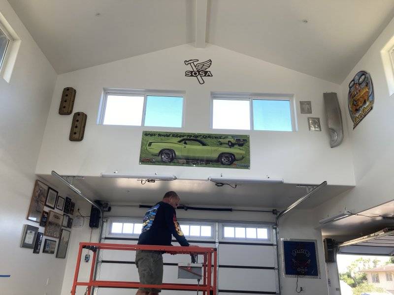

Dan, I just purchased a new 4 post lift that I am putting my 2021 1500 Ram on the bottom and a 64 Dodge Polara on the lift. My ceiling height is 14 ft and the car just fits under the garage door tracks. Hope this helps.Good morning, I am in the planning/permitting stage of building a stick built shop. I would like to eventually get a 4 post lift, what wall or ceiling height is generally needed?

12 foot walls is the highest I can go.Dan, I just purchased a new 4 post lift that I am putting my 2021 1500 Ram on the bottom and a 64 Dodge Polara on the lift. My ceiling height is 14 ft and the car just fits under the garage door tracks. Hope this helps.

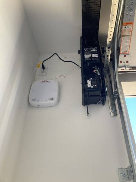

High rise track, I think, is a must for any shop build.Thats a good point for the build planning. My doors are 9x10 and 12x12 if memory serves me right. Conventional 8 wide and high doesn't leave much room for a truck/suv/crossover to get in. You can gain some clearance by having the tracks raised as high as possible for the door travel and also use a direct drive/jackshaft style opener. It mounts off to the side of the shaft/spring unit giving you way less obstruction under the door.
